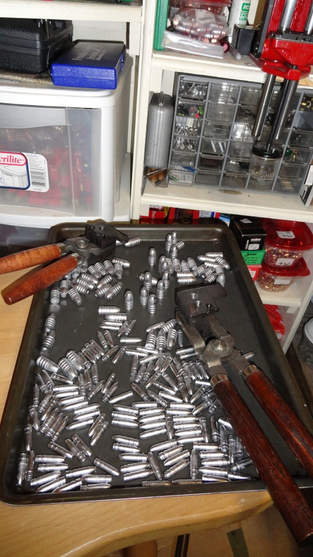

Cecil, this is the manual I was talking about. I'm pretty new to reloading and shooting all cast. I've found this to be very educational.
September 18, 2014 - 10:14 pm
I believe that is what my brother has. He pours lead too. I have thought about it but haven't got there yet.  Of course, he is almost entirely off the grid.
September 18, 2014 - 10:42 pm
I don't pour it, I buy them precast. Pretty darn good value when compared to clad or even plated. I don't think I could trust myself with a cauldron of bubbling lead!wow
September 18, 2014 - 10:57 pm
laughing you just gotta be sure the molds are hot too and dry I think... nothing says blisters like molten lead popping everywhere..lol
