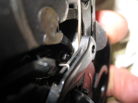

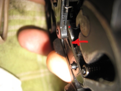

Is this 15-2 trigger return spring positioned correctly?
stonebuster
Forum Posts: 301
August 20, 2019
September 2, 2019 - 10:32 am
Is the leg of this trigger return spring in the correct position or should it be resting where the red dot is? It seemed odd to me it would be trapped on the inside of the lower hand and might interfere with it's movement. I know the previous owner had experimented with different trigger springs.IMG_0291_LI.jpgImage Enlarger
IMG_0289.JPGImage Enlarger
Forum Posts: 668
October 17, 2017
September 2, 2019 - 9:42 pm
The red dot marks the spot alright. The leg of the trigger return spring should be resting on that little ledge.
