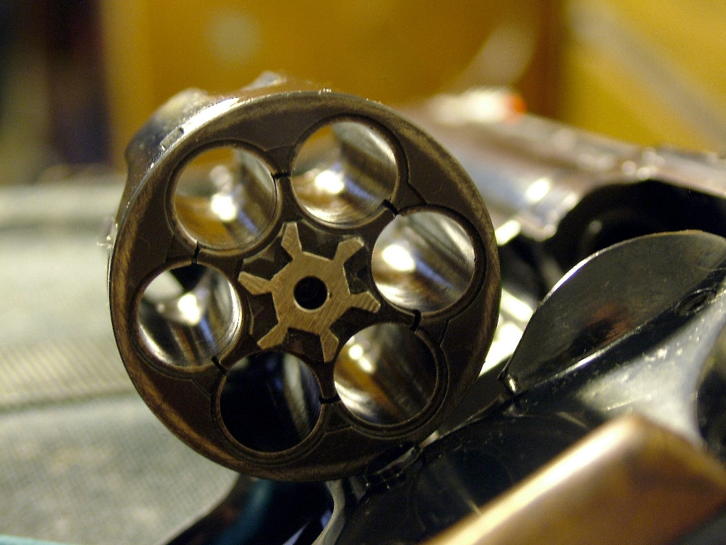

I used some 1/3" wide strips of Kitchen green "ScotchBrite" wrapped round a .30 cal jag & spun with a power screwdriver. It polished nicely while removing almost zero material. 1 dry, followed by one wet to finish.
That one chamber no longer hangs up.
