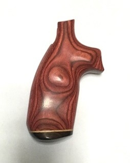

My custom Terrain Camo grip is done and should be here soon. I already have the Rosewood Laminate grip that's a stock item, #57530.
(Pics below.)

Aww. I forgot to attach the pics! Here ya go (edited to replace the HUGE pics)RW-Lam-Right-a-1.jpg

That sounds really cool! You can see from my pics that their guys do fine work, so all of your grips with medallions should be as nice as you expect them to be.

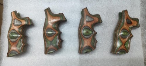

Here’s something for you, brother. They sent pics of the 4 greenish Lamo Camo grips they had a month ago. I don’t know what is left. If you want one, tell them you want #1, #2, #3, or #4. (attached below)
