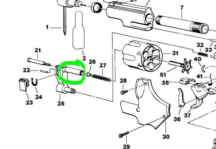

Would like to see pictures if possible? Are you saying this piece appears broken and permanently fixed?:
Yes exactly. The pics you circled along with pieces 26 and 27 in the photo are permanently inside the cylinder. I’m not home but will post pictures when I can.

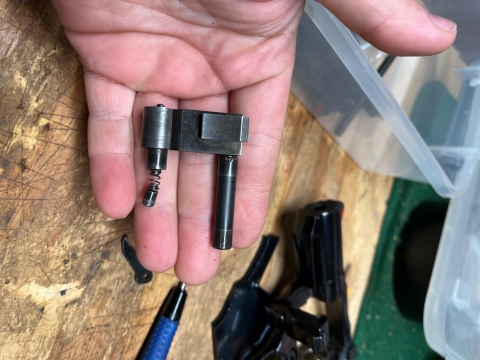

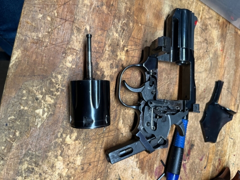

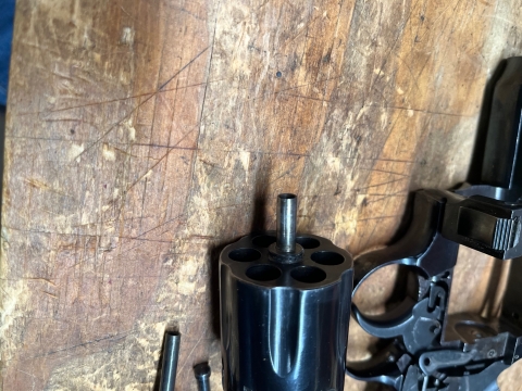

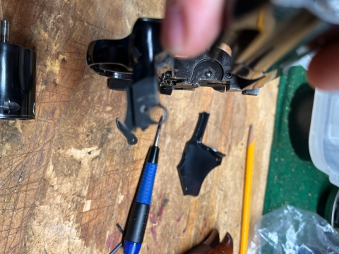

This is how the cylinder of my 15-2 takes down. Next to a spare crane I had for my model 14. It definitely looks broken and repaired incorrectly at some point.

October 3, 2024 - 5:08 pm
So it appears that the upper crane leg is turning freely enough in the crane to take the place of the cylinder revolving around it. Seems bizarre, but it apparently works, sort of. A replacement crane and cylinder is needed. As to which vintage would work I couldn’t say for certain. Good luck with this one.
