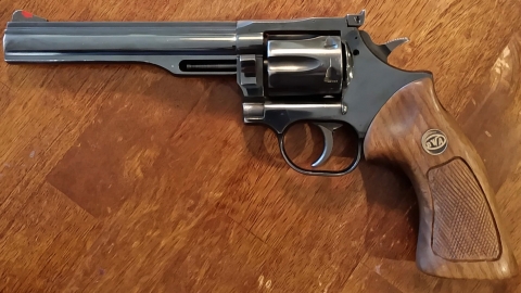

I have had this 15-2 for only a couple of days. I am waiting on tools and parts from EWK, before I really open it up and see what I am dealing with. But, I have been thinking ALOT about what to do about the blueing/finish on it, if everything checks out okay with it. This 15-2 is replacing a Ruger GP100 I got rid of years ago and immediately regretted. I would MUCH rather have the DW over the Ruger, so I want to make this one special. I used to do alot of handgun hunting and this 15-2 will be used for that, as well as everything else. I can tell this revolver was in and out of a holster quite a bit. Blueing is rubbed in normal spots for that. I actually wonder if it was a duty gun in the 80's. I am leaning in two directions with refinishing this revolver. Leave it as is, keep her clean, and not worry about the blueing as much, OR, have it Cerakoted in a custom color scheme. One color one the frame and barrel shroud, and a different, slightly offset color on the cylinder and yoke. It will get new exotic wood grips, either way. I have the hands of a 4 year old girl and the huge target grips on it now are just to much. Anyway, has anyone here had their DW Cerakoted and what did you think of the end product? Is Cerakoting a DW revolver blasphemy, or acceptable? I do know that if this revolver is in good shape internally, I am not worried about resale value, or anything like that. I will never get rid of it. I have waited to long to own a DW. Thanks for your time, Y'all!!!

It's your to do with what you want. That said the 15-2 is the most popular model made and they are plentiful, so I don't think doing one in Cerakote would have you shunned from the community, lol. If you do go that route it is worth investigating the applicators since they are all far from equal. I've seen/read the results of what happens with second rate Cerakote jobs. I would personally find someone who could get a DLC coating applied. Then you have the best of both worlds, looks like bluing but is very durable.

Maybe it’s just me, but I look at the attached photo and think; dang, that revolver is beautiful. I wish I had one just like it! Still, it is your revolver, so you are free to do with it what you like. There are soooo many options open to you, just try to get quality work. As for the grips; again there are many options to be found on eBay, but take a look at Hogue and Pachmayr as well.
