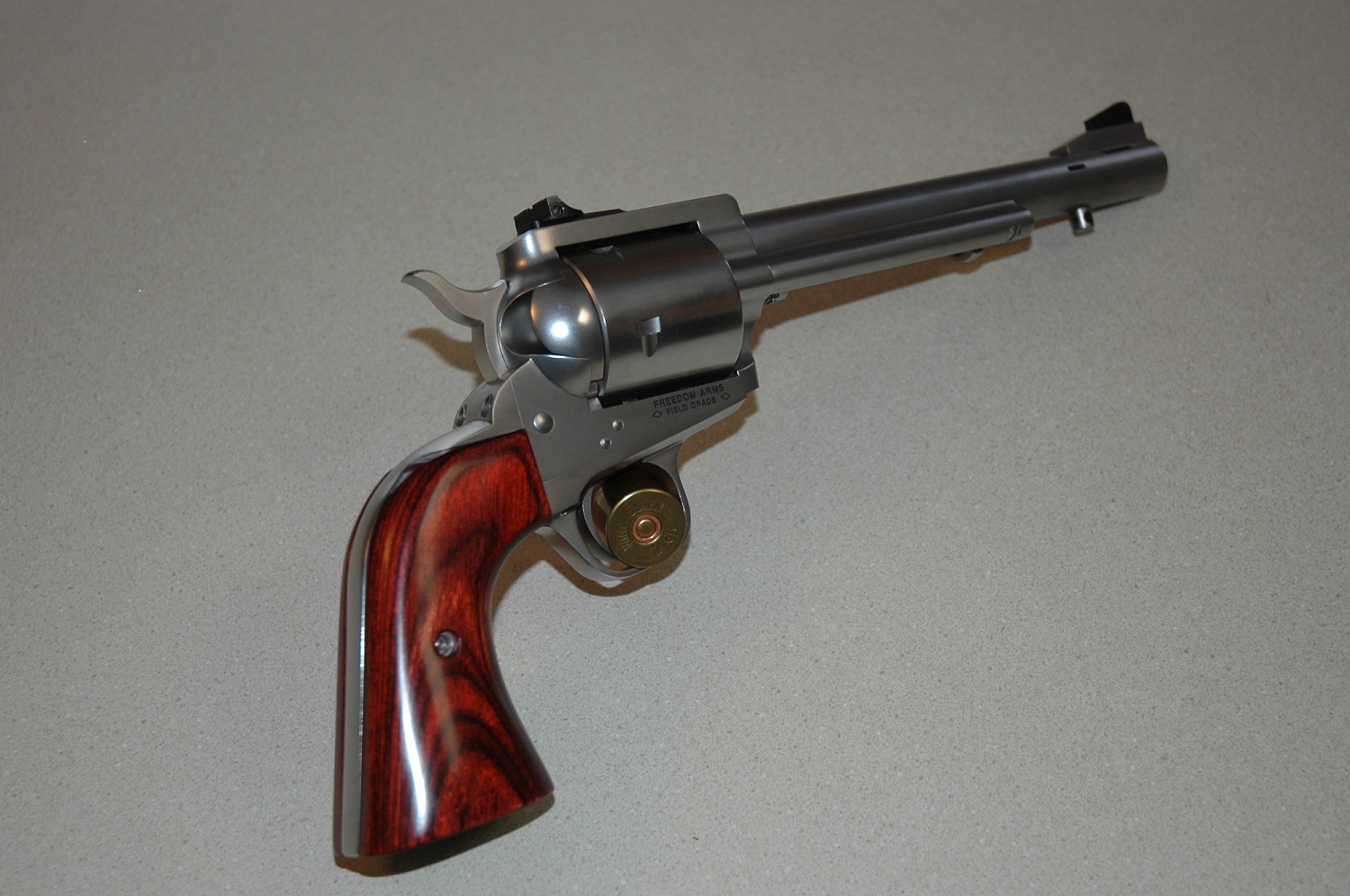

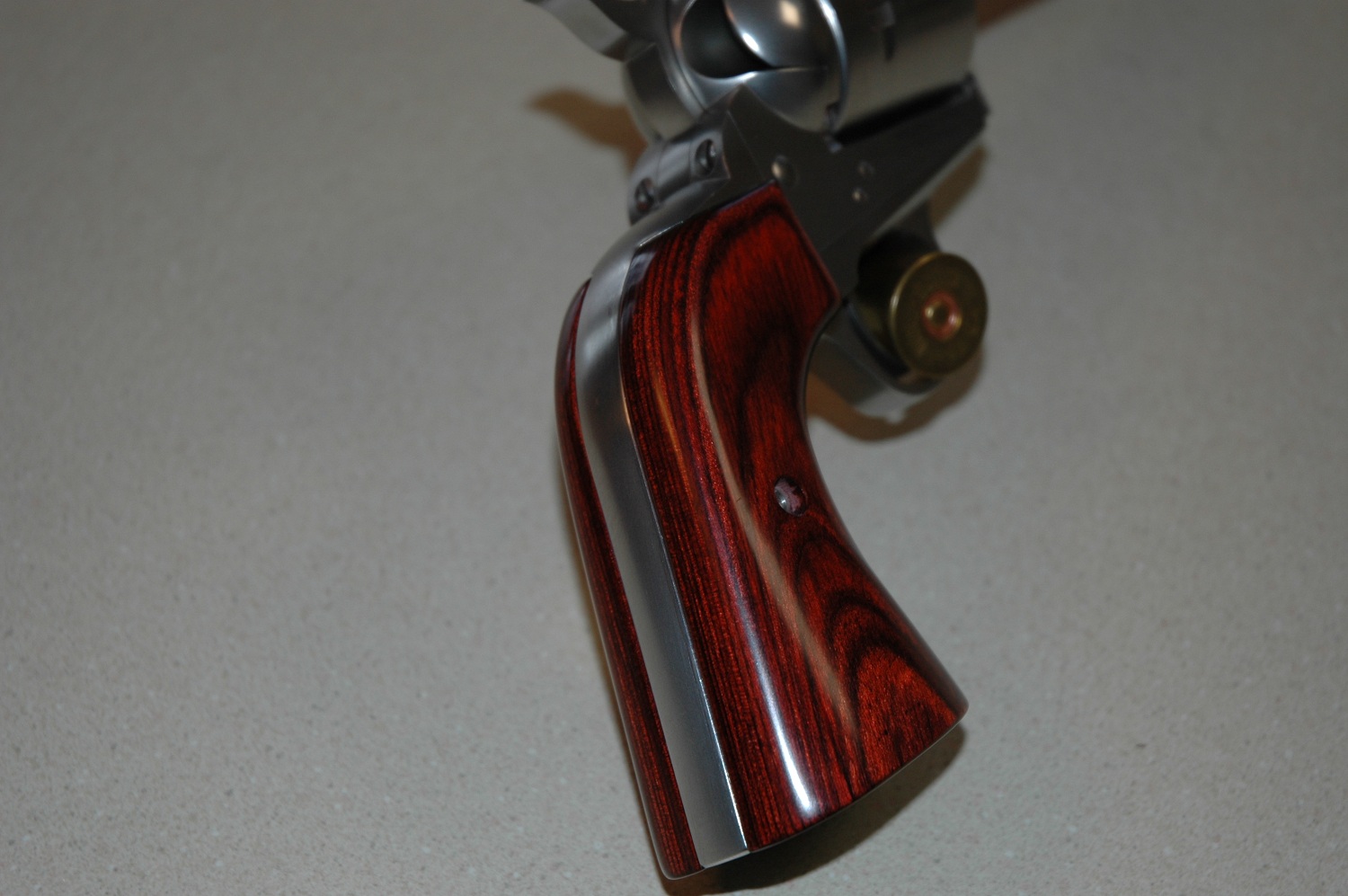

Okay Gents, this was a fun winter project and I appreciate the advice from the forum members. The Freedom Arms model 83 was my 25th anniversary gift this past November, always wanted a .454 Casull. Found a lightly used one and pulled the trigger, but it was originally ordered with Pachmeyer grips. Called Freedom Arms and they wanted $250 to make a set of wood grips and would need the gun shipped to them, wholly cow I thought to myself. The nice lady on the phone said they have blank grips that they use and are rough cut about an quarter inch oversized and need drilled to receive the pin, then worked down to fit the frame for approximately $50. Well what did I have to loose. Turned out pretty good for an amateur.

Wow, those grips look fantastic!!drool Nice work, and thanks for showing them off!

January 29, 2014 - 9:27 pm
Absolutely outstanding!! worship

January 29, 2014 - 9:43 pm

worship.   Trust me guys, getting a set of SA grips fitted correctly is harder than it looks. Great job Greg!

It looks hard also!!!!  Fitting all the corners and the contour to the backstrap perfectly looks very hard!!  Nice job!
