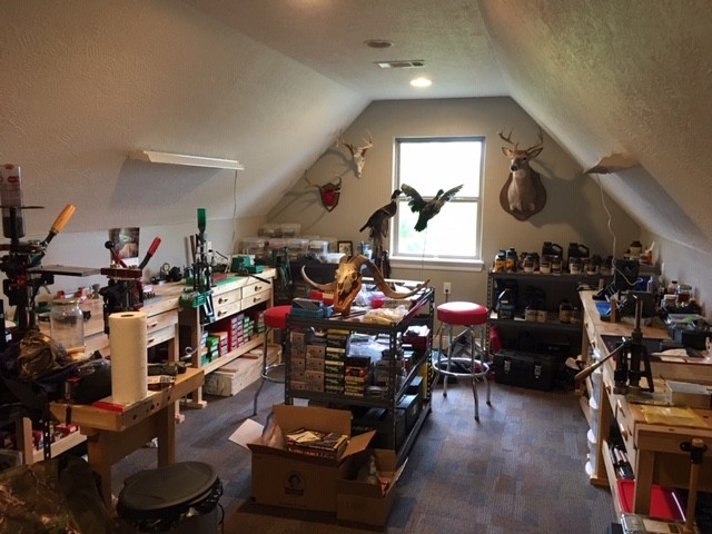

40Cal said Problem is, do you have enough room for all the dies, powder, equipment etc as realize you can make any caliber? Then you'll need all the guns to go with it.
Or too much room and bam!  another addiction:
Reloading-Rm-MAR-2020-1.JPGImage Enlarger
