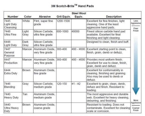

Here's a grit chart l found.
I know, I gave it to you in post #9 ... ha, ha, ha. occasion

October 1, 2018 - 1:50 pm
Some coincidence...I swear l found it on google images!  Lol! At any rate, it's there!

photohause said
Can someone make this chart a Sticky please?
It's already downloaded to the archive.

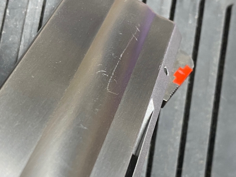

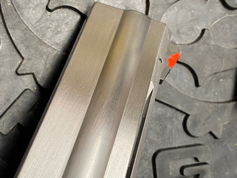

I used the 7448 gray pads to remove the scratches on my shroud but it appears I should have used the 7446 gray which is aluminum oxide and the chart specifically says for SS. Doh! 😣 Well it came out fine so maybe it doesn’t matter if you use silicon carbide or aluminum oxide?
Before:
8A5D138C-270F-46A6-BF9C-0FD7038F5EE9.jpegImage Enlarger
After:
2BD73EC6-5EFE-485F-8025-AD37C8CC6983.jpegImage Enlarger
7F80CDC1-7C02-4E86-BF09-2E08EC52E8BD.jpegImage Enlarger
