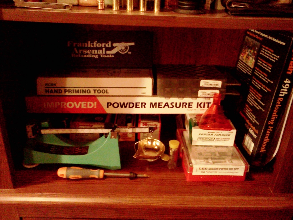

I just started getting into reloading, but on a tight budget. I wanted to make sure I got all quality down the road, so I am building up piecemeal. I inherited a RCBS 5-0-5 scale years ago. I decided that I could wait on an electronic scale, a powder measure, and trimmer until I could afford good ones (I am only reloading revolver catridges right now, so don't need a trimmer yet).
So in addition to the manual scale, I have a Lyman Pocket deburrer, Forester outside/inside case deburrer, a Frankford Arsenal electronic caliper, an RCBS hand priming tool, a set of Lee Powder Measure scoops, a powder trickler, funnel, dies, shell holders, and 2 universal loading blocks.  My single stage press is attached to a workbench in the garage (RCBS O Press, $40 from a friend).
I weigh every charge with my setup: use the closet scoop that loads as close to, but under, my desired charge; then use the trickler to bring the powder up to the desired weight (scale works great with the trickler, no bouncing around); and then dump it in the case.  Works great for me so far.  I actually am glad that I am weighing each charge right now by hand, it makes me really know my loads and firearms. Then when I go to the "automated" powder measures, I will have a much better feel for my loads and see if my groups open up, etc. Pretty sure I'll get an electronic scale too but next on my list is a trimmer setup and rifle dies. Goes pretty fast with the trickler, but that ONE step takes probably about 10 times longer than if I had a powder measure. Not an issue yet though.
Mostly everything I have is in the photo below, including 500+ 44 mag bullets.  Oh, I got the 4 die pistol die sets, so the last die does a full resize on the case while it does a crimp. Probably not needed, but I'd rather not seat and crimp at the same time while I am learning.
I am enjoying the setup as is right now. The only thing that really bugs me is cleaning the trickler out, hard to get all the powder out without giving it a good cleaning every time....

Headsmaster.....I would say that you have a good handle on reloading.   When I started I worked off a bench that was clamped to a Black & Decker Work Mate.  The unit was set up in our spar bedroom.   When we had over night guest I would slide the whole set up under the bed.   We all like a perfect set up but some times you have to make do.  R S
