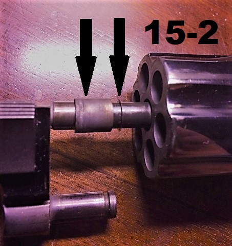

On older DW's the front of the cylinder had a Removeable (somewhat) section (the gas ring) against the Crane.
https://www.triggershims.com/img/content/15-2%20Cylinder%20Shim%20&%20Bushing.jpg
Later on the cylinder is one piece, and can be shimmed like all other of the type
Photos courtesy Trigger Shims .COM
Easily noted due to that "ring" on crane of Later models!!

If the gas ring fit is too loose the cylinder will turn around on it instead of carrying the ring with it as it’s supposed to. The gas ring will just sit in one place with the hot gasses burning at the same spot instead of distributing it around the entire ring as the cylinder turns. I’ll let the panel decide if that’s a problem or not.
April 5, 2025 - 1:31 am
Racepres, thanks for posting those pics & the explanation. I can see why the gas ring has been built into the front of the cylinder of most any revolver out there. I have heard previous mention of a removable gas ring on DW revolvers, but this is the first I've seen pics of one actually removed. Until today, I had presumed they were all cut into the face of the cylinder as part of the cylinder manufacturing process.
Tonight, I looked at 4 of my early DW's, and I still can't see that the gas ring is a separate piece. Geez, I even looked at one of my Ruger Super Blackhawk's, that one looks pretty much like the DW's. I will admit that I'm not willing to try to pry one of them outta there on one of my DW's just yet... lol2 So I will have to assume they are all wearing separate bushings & just can't see 'em.

Again..Only Early DW's have that replaceable gas ring. The way you tell is ...Looking at the Second Picture. That Donut machined as part of the Crane. Indicates a Cylinder that has the ring integral to the Cylinder. Note that the Crane in the First photo does Not have that Donut machined into the Crane.. just the "shaft" protruding.. passing thru the Removable gas ring. Donut=Later model without removable gas ring.

Yes...I own one each, Pork Chop and Early 15-2 both utilize the Fire ring! I do own a later cylinder/crane assembly.. but alas, not the same ...as It incorporates the Donut integral to the Crane!!

Welp... The Only Problem with the Pork Chop cylinder, is the Chambers are Not done well from the begining. Rough machining.
I have Never seen a Damaged Gas ring...But, as Noted...the Gas ring establishes Headspace..just like the front of an integral cylinder establishes headspace. Hence the gas ring needs to be replaced to establish proper Headspace. (this spare one is excessive)
Yes, this Pork Chop has the Same Cylinder as the Early 14-2, 15-2. I confused the issue, in that I do have a Later 14-2, 15-2 Cylinder and Crane.. and am now wondering if Crane and all may be a Replacement option...Only on the 15-2! Which BTW don't need it.. Obviously the crane won't work on the PorkChop!  Too Many Parts...But, None of the correct ones just now!! Not Insurmountable at all..
Edit; @3ric, I noticed you (and Others) have previously posted about Early Dans having Rough Chambers!! I do Not wish to "hone" my Cylinder...tho, I suspect a Proper Chamber Ream would have cured my Woes Long Ago!! I have Never intended this particular piece to undergo "stout" loadings...and so..The 38-44HD loadings have been perfectly satisfactory.
