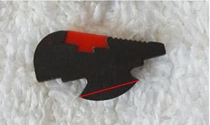

Attacked the problem as a father/son project.  Using my caliper and its depth gauge, I discovered that while the slots were uniform across all four shrouds, the pin in the 8" shroud had been incorrectly drilled deeper and further forwards in the slot.  Using jeweler files and over around four hours, alternating between a tiny rat-tail and half bastard, I changed one sight so that it now sits perfectly (removed area in purple). A great deal of satisfaction when it finally sat in snugly and locked in place.  Thanks all for the advice.
https://www.dropbox.com/s/prdfpe3xmzits8m/Sight-2.jpg?dl=0

Interesting problem and perfect resolution .. thanks for the update.
