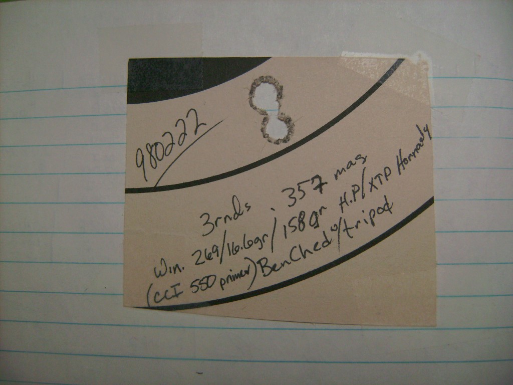

Without pictures, it's tough to say.  Is there evidence of flow back into the firing pin hole?  Flat primers and sticking brass is just an indicator.  It could also be that brass is softer and the primer holes are bigger, so again- it's tough to say.  A good rule of thumb when finding "max" loads is to use the same components each time and not mix headstamps/ bullets/ primers.
I always start about 10% below max published load and work up.  On a 17 gr. published max load, I'd personally start at 15.5 gr. and work up.  That's just me but it has kept everything safe for many years.
BTW- I rarely find that the max load is the most accurate…. my $.02
 The pic has been my most accurate .357 load since the late 90's.  Hard recoil and a proven game taker.

Thats a nice group there! Thes best I have done is about and 1.25-1.5 inchs at 25 yds....I claim user error
