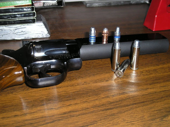

I posted this image in another thread but it bears repeating here:
That sucker on the left is 180gr of lead.
The powder is LilGun 13.1gr. There wasnt a table entry for cast bullets so I just loaded low for an equal weight 180JHP.  For the JHP the speed was suppose to be over 1100 FPS out of a 7.7" barrel ( who makes that?)
I did and do like the LilGun. It is a much slower powder and does not have that ear -piercing pop of TiteGroup. But make no mistake it makes some power! The only thing I did NOT like about it was when I went to loading 158 JHP, the powder was 17gr.. basically I sucked down a pound of powder with just over 400 bullets! Thats getting expensive.

Thanks to owning more than one DW 15-2…. I found out that the cylinder on the gun with the EWK shroud is too "small" tight. Its about 50/50 as to wheather a .357 round will fit without having to be shoved down into it. While all the other guns do just fine.

That is a good range report.  Glad to hear when a member has time for load experimentation and then the equal time to try them out.  On the tight cylinder notion..  Is it possible that these were the 180 grain only rounds that posed the problem?  Maybe the slightly longer than normal round wanted to stretch beyond the factory reaming area of the cylinder?  I experienced this in my 7414 when loading Hornady XTP's   since the 7414's were pretty much developed using Sierra manufactured bullets the shape of the XTP was not working and the cylinder had to be reamed slightly more to allow their use.  Using that thought you may be experiencing something similar?
October 7, 2011 - 9:14 am
Yes, so far only the 180gr rounds are causing the issue ... but only in the one gun.  The other four work fine. I also think it not so much length as it is the heavy ALOX on them causes the case to be bulged at the mouth (versus that slight taper from the crimp).

Look up some more load data for those 180's and make sure you are not driving them too fast--that makes recoil ya know wink....
If you think your cases are bulging, invest a few bucks in a lee factory crimp die--they work wonders on guns with tight chambers.
