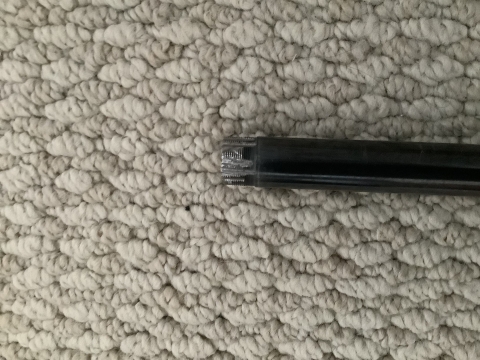

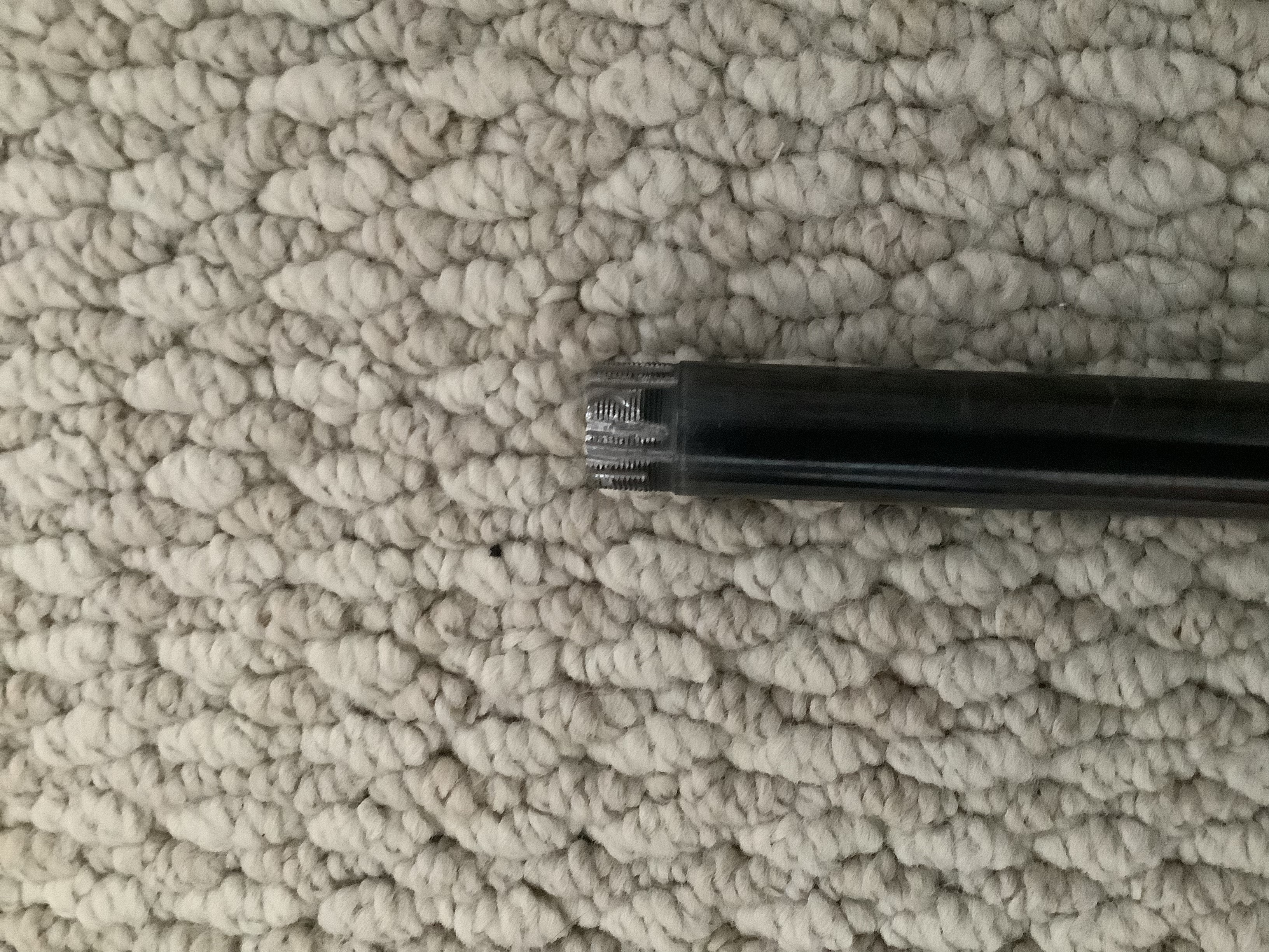

Well…you have forced me to define “damaged” with a picture
6548E38B-1610-4BE3-8C06-9C3FD57032B5.jpegImage Enlarger
I have always done most everything myself guns
there has been hardly anything I have ever needed a gunsmith for …. But, this is definitely one of them
will probably end up sending to CZ, it can probably go from a 8 inch amputee to 6” barrel
thanks

Looks like a barrel nut got rounded out (way over tightened or thread locker) and had to be drilled to make it come out in pieces. Don't know why they had to drill it so many times for the one time I had to do it all I needed was one 1/16" bit thru it to loosen and then tapped it out with a punch. Cheaper to just buy a new barrel from DW.
August 14, 2023 - 3:31 am
Dayumm!! wow That poor thing is definitely hurt. cry

August 14, 2023 - 5:18 am
yep….gun abuse should be a crime
hopefully cz can at least amputate to 6” barrel

New 44 Mag Barrel Only: $110 + $30 shipping.    Ordered from DW-CZ.   took about 2 weeks to arrive

I doubt that Keith will touch it.   If Bob were still there, he certainly would.   I have a less-damaged 740 barrel.   I was convinced to buy a new one instead of sending it in.

ordered a new 8” barrel….very reasonable
Keith said he would let me know if it makes sense $$ to cut down to 6”
I was able to repair the shroud
