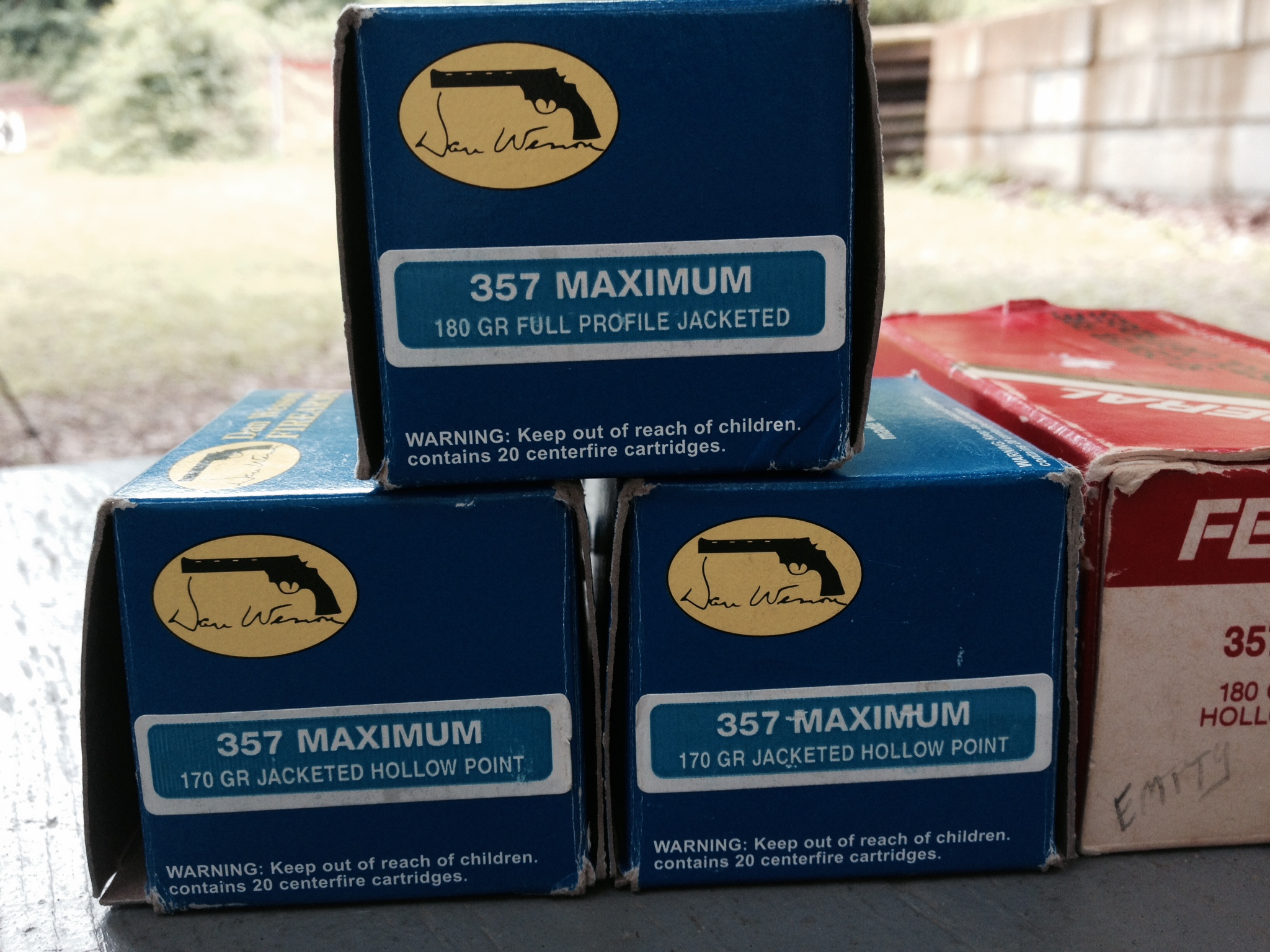

Got some 170 and 180 grain Dan Wesson Factory .357 Super Magnum ammo.  Any one know what they loaded this stuff with???
Here is the chrono data for it out of my 10"  DW Super MAG
Set: 71
Created: 07/06/15 12:08 PM
Description: dan Wesson 357 super mag 10"
Notes 1: dw factory ammo
Notes 2: 180 grain jhp
Distance to Chrono(FT): 10.00
Ballistic Coefficient: 1.000
Bullet Weight(gr): 180.00
Temp: 80 °F
BP: 30.13 inHg
Shots:
#    FPS / FT-LBS
5    1372 / 752
4    1374 / 755
3    1363 / 743
2    1374 / 755
1    1366 / 746
Average: 1369.8 FPS
SD: 5.0 FPS
Min: 1363 FPS
Max: 1374 FPS
Spread: 11 FPS
True MV: 1371 FPS
Set: 70
Created: 07/06/15 12:04 PM
Notes 2: 170 grain kph
Bullet Weight(gr): 170.00
Temp: 77 °F
BP: 30.12 inHg
Shots:
#    FPS / FT-LBS
5    1425 / 767
4    1502 / 852
3    1476 / 823
2    1438 / 781
1    1434 / 776
Average: 1455.0 FPS
SD: 32.7 FPS
Min: 1425 FPS
Max: 1502 FPS
Spread: 77 FPS
True MV: 1456 FPS
photo-1.JPGImage Enlarger

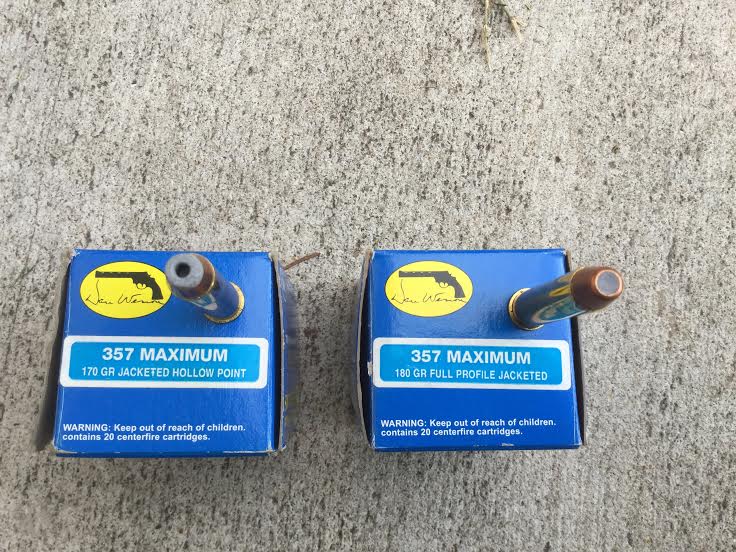

Didn't know that. Probably rebranded by some ammo manufacturer. Is there any info which one?
PAbowhunter
Forum Posts: 250
April 9, 2015
July 8, 2015 - 6:49 pm
unnamed.jpgImage Enlarger
I am guessing the bullets are Sierras.  I will pull one and weigh the powder and see what it look like.  I am guessing either H110 or IMR 4227 being that they have been around awhile.  I'll take pics.
