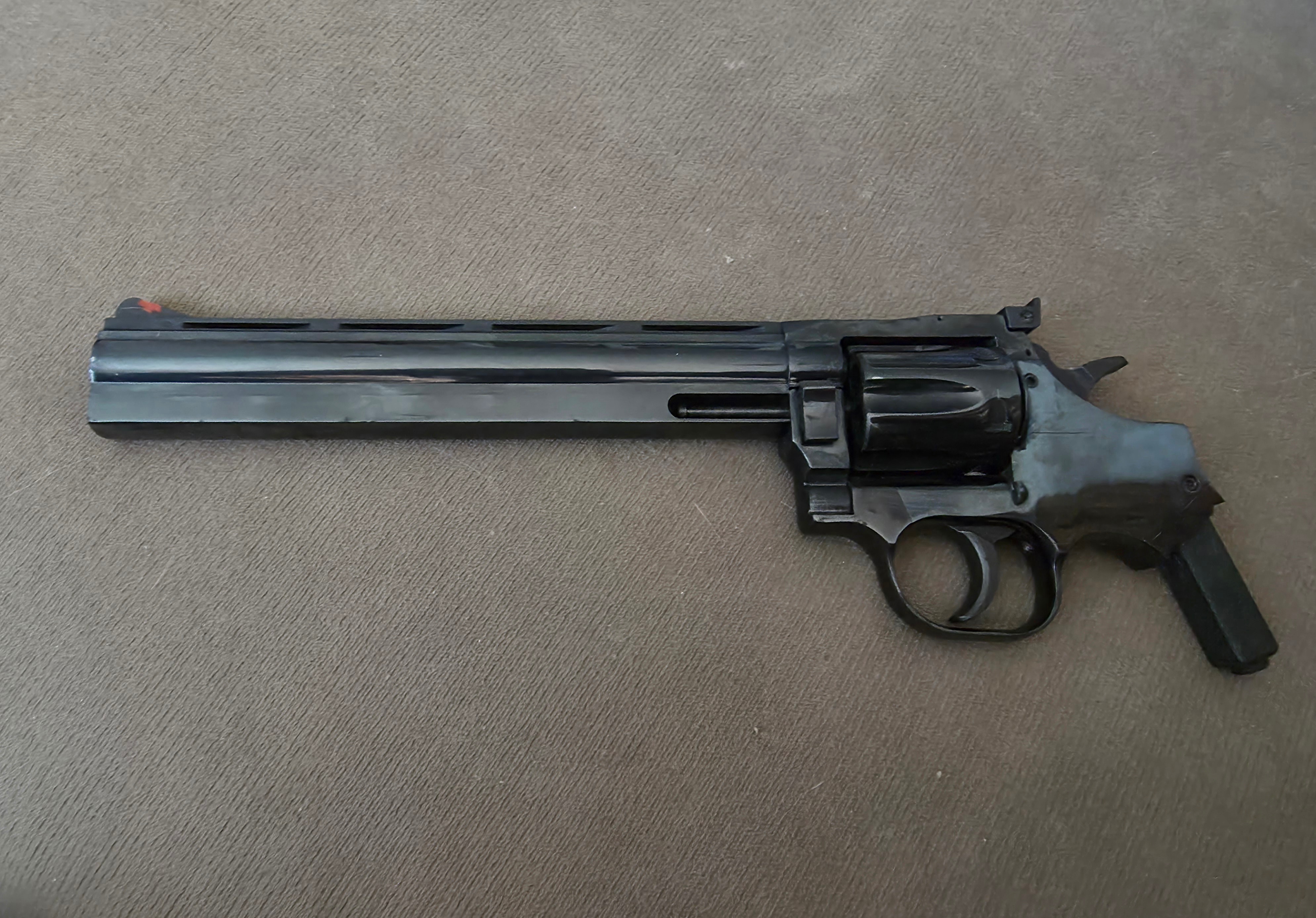

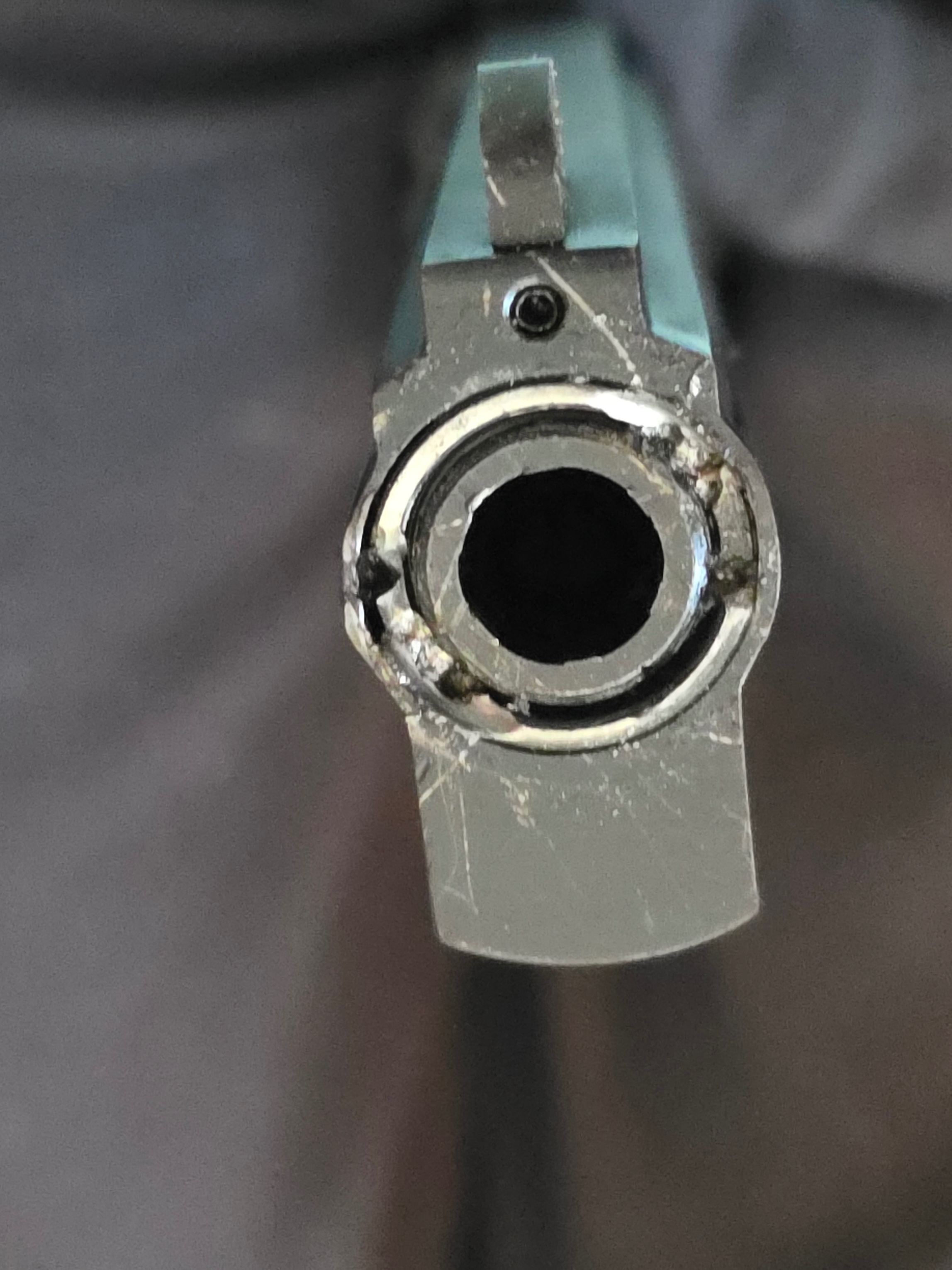

I purchased a damaged barrel nut 8 inch VH 15–2 in otherwise in outstanding condition it was a very good price reflecting the damaged barrel nut
Now I’m looking for the magic solution to remove the barrel nut ….on close inspection, I think the right side shroud threading is damaged.
I’m usually pretty good at these type repairs except this time, unless someone here has a DYI solution, looking for suggestion for a DW Gunsmith
I think those are few and far between …so any suggestion for a competent DW Gunsmith much appreciated
if I can’t get this repaired, I have a beautiful 8VH fixed barrel 15–2
Thanks

Here is my advice to you.....that nut isn't coming off and even if it did come off it's damaged, a.k.a. destroyed as well as the shroud and barrel.  The barrel crown is shot as well.  You'd be best off just cutting it off and replacing it with a another barrel assembly.  Even if you found a machinist to shorten it to a 6" barrel assy. you'd end up putting more $$ into labor than it's worth.
I've  never heard of a "DW Gunsmith", other than those at the factory and even though they generally do a good job, I was not pleased with some of the results (such as gripping the extractor rods with pliers to remove them and leaving teeth marks in the extractor rod).  If you send that gun somewhere to get worked on you risk seeing additional damage to the frame as well depending on how precise and detailed the "gunsmith" is.  Do yourself a favor and just cut it off, throw it out and replace it.

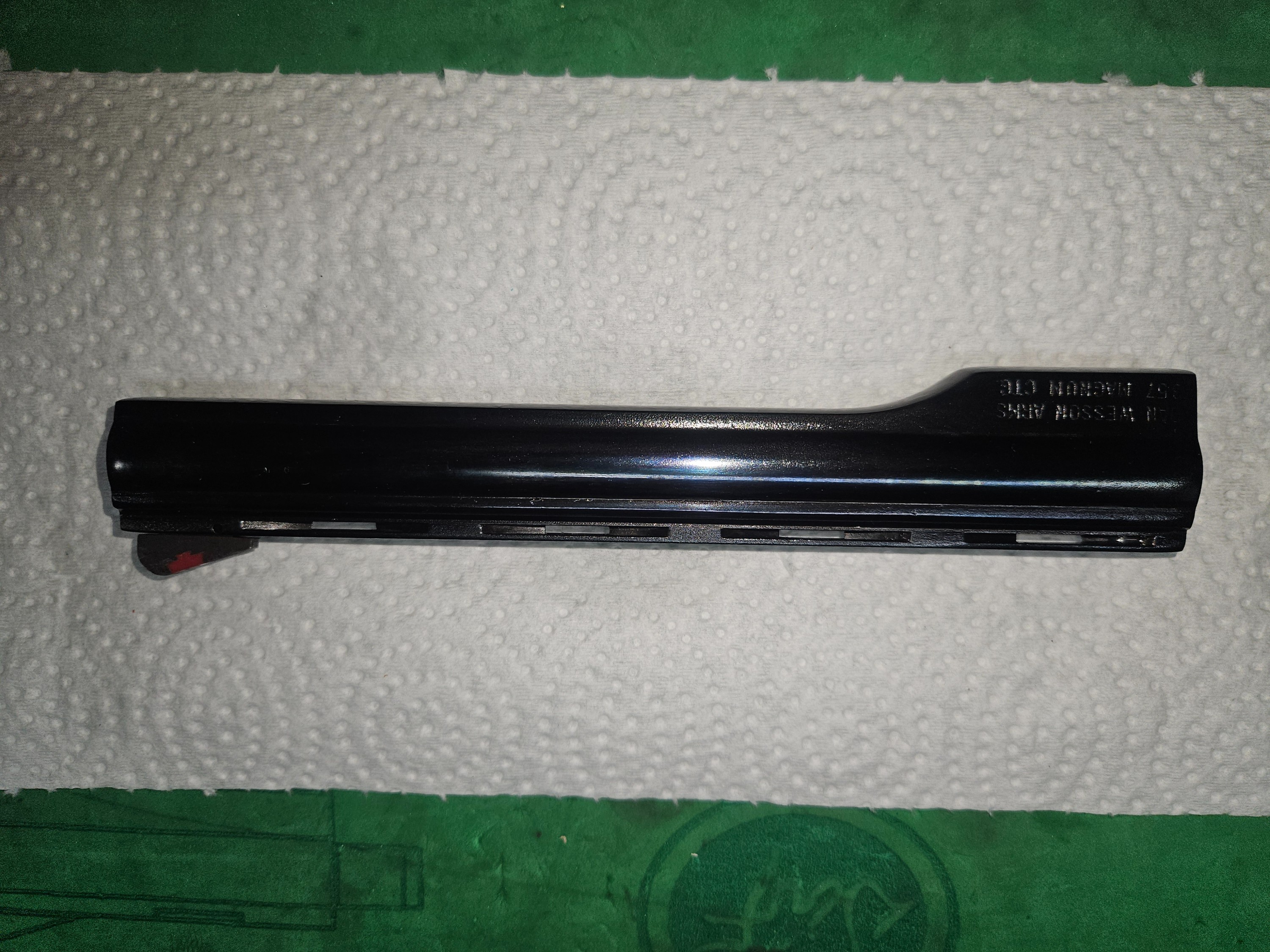

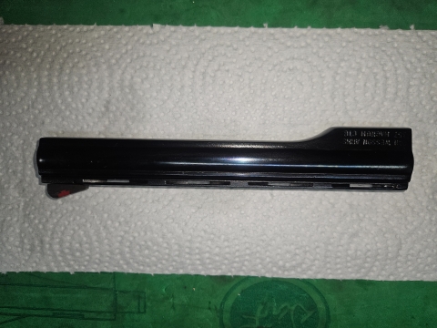

I'm attaching an after pic of an old rusty 8V shroud i picked up with some other stuff at a show over 10 years ago.  It was a mess.  It's been sitting in my shop since, I forgot about it.  I found it while looking for something else recently.  During the big snow and freeze we had last month, I decided to try to save it.  I spent several hours with wire brushes, sanders, sand paper, fine steel wool and finally a cloth wheel and compound to polish it.  A few applications of blueing paste and its not bad. It's not perfect but its functional.  I left a few pits that were too deep to remove and produce a nice finish.  This will make a nice shooter shroud.  I don't have a before pic, but it was a total wreck.20260301_181807.jpgImage Enlarger

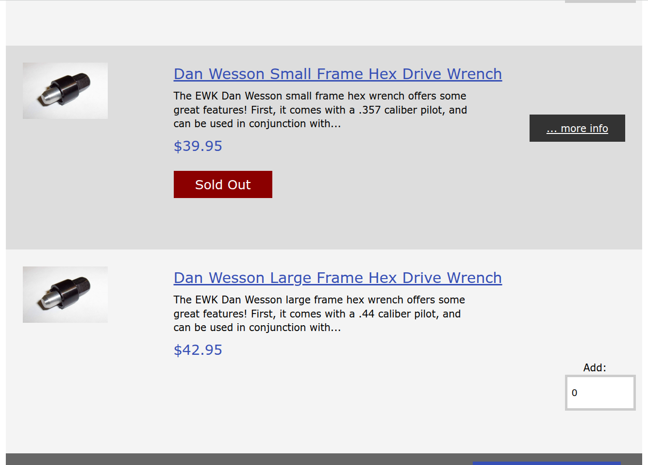

I use this tool from EWK Screenshot-2026-03-02-3.40.37-AM.pngImage Enlarger
all the time for stuck nuts but it's out of stock at this time. This lets you put it in a vice and use a breaker bar on them. has worked every time. I use a lot of WD-40 also if it's really stuck you can put a clamp on the top and bottom to keep the tool from slipping off.

I actually made one sort of like that for small frame. I took one of the hex nut barrel tools, and use some J.B. weld to secure it permanently in a socket. Then I use a hammer drill slow speed. It has broke loose.Many stuck barrel nuts, the problem that I have right now is the barrel nut is completely stripped so I’m going to attack it with a 1/16 inch drill and punch as described above ….have to wait until this weekend when I have an appropriate amount of Rum.
