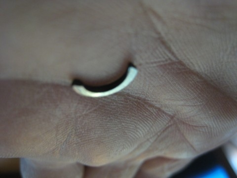

I replaced the cylinder yoke latch shown with a new one from EWK. Is this supposed to be fitted by taking one side down flat until it fits snug? I put the new one, which was rounded on both sides, in as is and it's a bit tight opening the cylinder. This also opened up the B/C gap from .007 to .014. I replaced the latch because the rounded front part of the yoke was proud to the frame and I could push it forward to flush easily. I had been experiencing some light strikes and I thought replacement might correct it. Other than the cylinder/yoke being slightly harder to swing open the gun dry fires normally.  Should I flatten one side of the "latch" some?IMG_2442.JPG

I think what you have is a crane LOCK. If it's under the sideplate and keeps the cylinder assembly from sliding off. It is perfectly okay to flatten a side to fit.

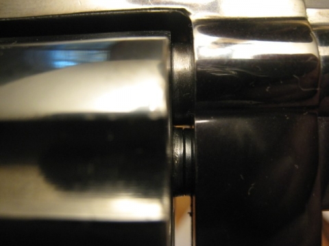

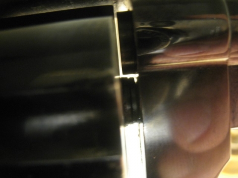

Sorry for the late reply, busy with fall yard cleanup. I should 've posted it's a small frame 15-2 Monson 357. After your previous post with concerns about creating a gap between cylinder bushing and frame, I took some photos to check area of concern. I see a small gap in that area and think it would be wise for me to file the cylinder lock flatter on one side so it's not pushing the cylinder away from frame. Then I can install an endshake cylinder bushing/shim to move the cylinder back to try to eliminate light strikes. BTW, I tried 100 rounds using CCI #400 SRP with my 38spl reloads with gun as it is now with no light strikes. I used small rifle primers because they're thicker, harder to ignite, than CCI SPP. As you suggested it's probably not the way to fix my light strike issue though. What do you think about what the photo shows?IMG_2465.JPGImage Enlarger

Yes, the photos clearly show what I was concerned about. That gap should not be there. I’m not sure why your crane fits the gun the way it does. Do you know if it’s original to the gun? After 100 rounds fired, do you feel any difference in how the crane opens and closes?

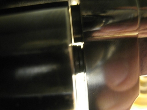

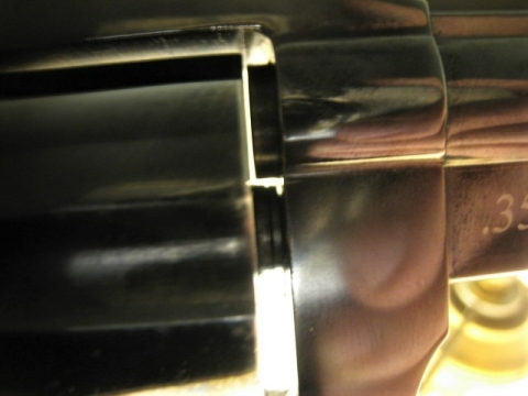

The crane was tighter rubbing on the frame more with the thicker cylinder lock. The wider cylinder lock pushed the crane & cylinder back causing the gap. I replaced the new cylinder lock with the narrower original one and the gap is gone and normal(?) as the new photo shows. I haven't reset the B/C gap yet as it closed up again(but not dragging on barrel) after reinstalling the original cylinder lock. It seems the ball in the recoil shield was pushed back farther with the thicker lock. Before and after photos. Back to square one and on to trying to loosen the ejector rod to add shim .002 to get a better strike on the primers. This should move the cylinder back while keeping the crane where it belongs. I've read all the posts here regarding light strike causes and exhausted all the other options.IMG_2476.JPGImage Enlarger

That looks so much better, and as it should be. I think you could add at least .005 shim material to start with. This is more likely to help with the light strikes. Check your endshake after adding the shims to be sure you’re not running too tight, but I doubt it. Yes, the detent ball will be pushed a little farther into the recoil shield as you move the cylinder rearward, but this is normal, and not a problem. Once you arrive at the ideal amount of shims for the total that works best, I would try to get a single shim of that thickness; it will hold up better to the hot gases.
