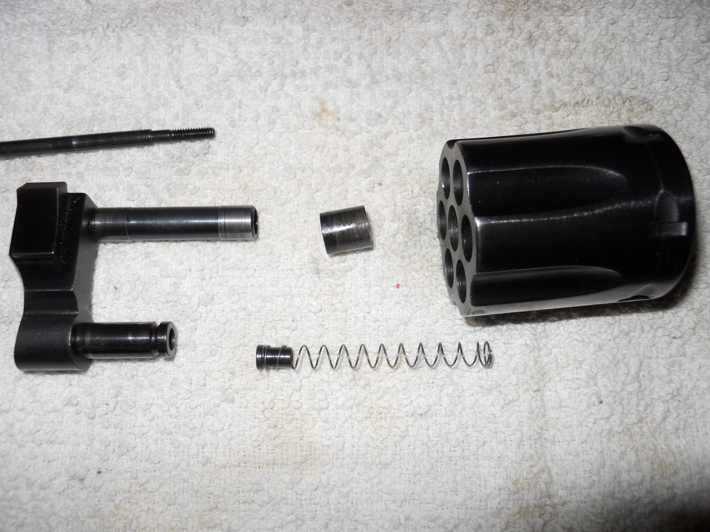

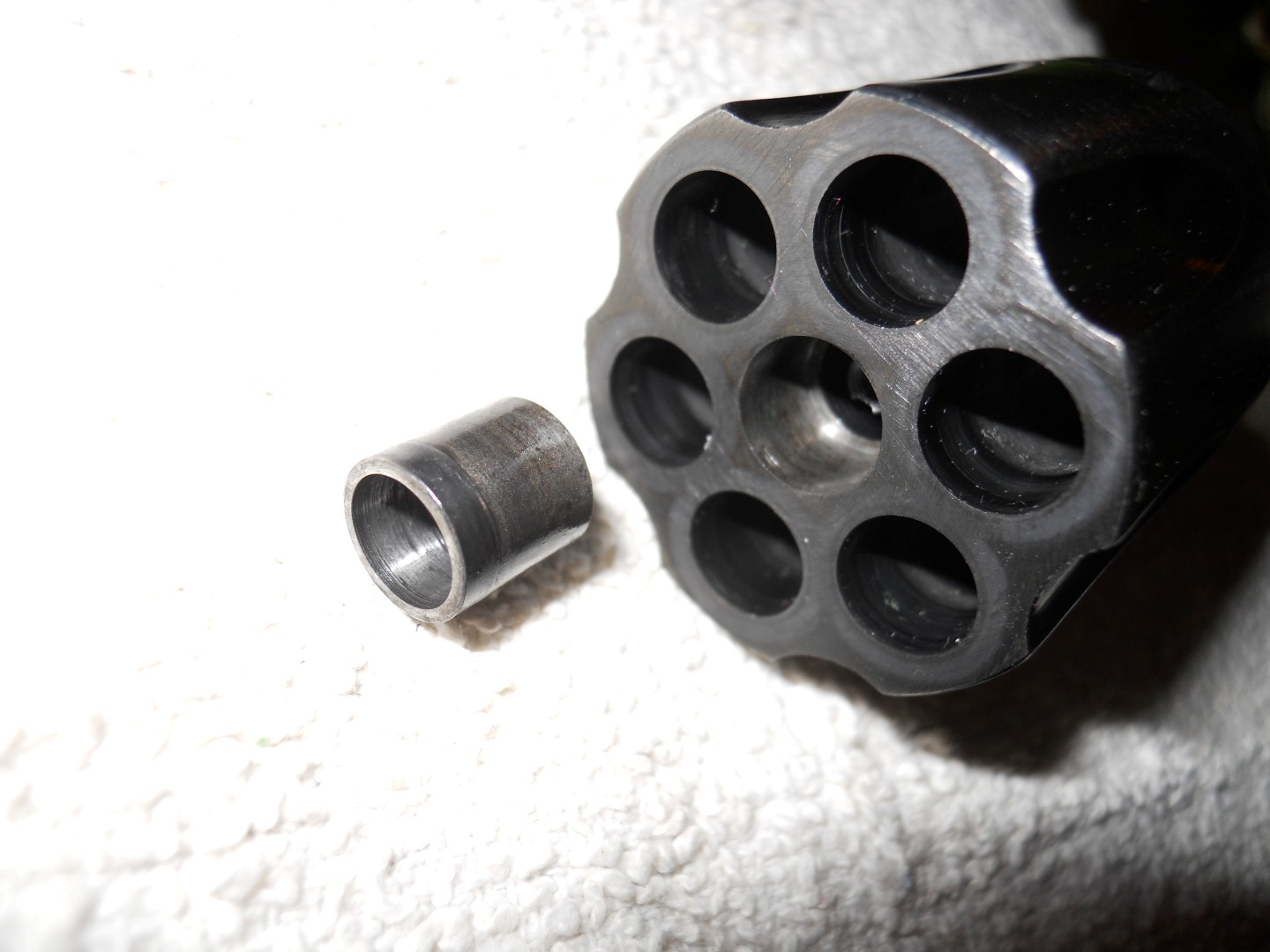

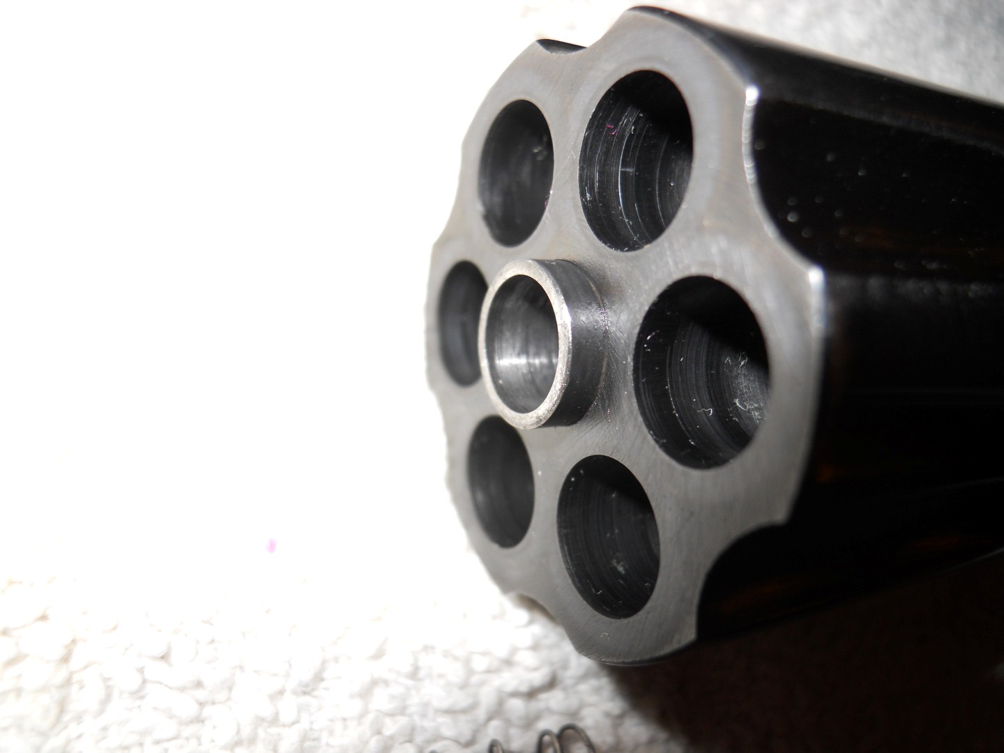

   I have one Dan, that has a little sleeve that fits in the front of the cylinder. (see my pics). On this gun it seems to want to fit in only one way. So, I am saying, does your gun have this setup, and is it possible that you turned it around, and it doesn't fit in quite all the way, therefore pushing the cylinder back eversoslightly and making the star drag a bit on the back of the frame?
   I know I am really grasping so I apologize if I am just confusing you more. I have 6 small frame Dans but only the one is made like this, it is an older one.
-Lonwolf

I can see a line but if it is a sleeve it is stuck very well. Also this is the first time I've had the gun torn down this far, so I didn't put it in backwards. Maybe a previous owner...
