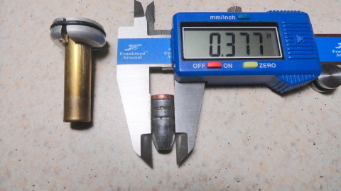

Started to hijack the 357 light load thread and thought I'd elaborate here.  There is always concern about crimping cast bullets.  The key is balance; alloy/crimp/velocity/size etc..  As an example, below are pictures of a 375 SM boolit, wide flat nose-gas check- 12 BHN, that I intend to hunt with this year.  The first picture is a sized boolit in the caliper and a loaded, annealed, case with medium to heavy crimp.  The caliper shows .377"; .001" over my cylinder throat size.

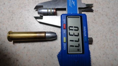

Next, I disassembled the loaded round with 4 med raps of the mallet.
As you can see, the case mouth opened up and the size of the disassembled boolit is unchanged.
