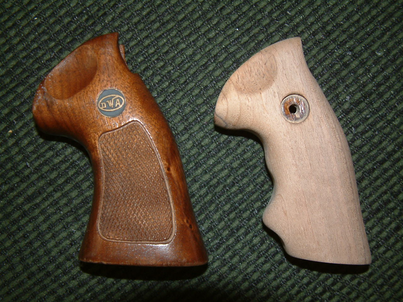

So what to do with all those stock DW full size target grips that are in less than pristine condition....Confused  Bust out the files and transform them into a nice custom grip!  I spent a little time after lunch on this one today...
I'm going to do a little more filing--a little more sanding-- and then some polishing.  We'll see if it turns out nice enough to transform a few more of the old beater grips into something new and original.

Guys, I'm no carver either... but a drawer full of extra grips gets me thinking I could do it Laugh  It's really not that bad--take a heavy file and do some serious gouging to the grip (yep, it's gonna look really ugly), then clean it up with sandpaper.  I'm just wondering how good it is going to look once I put the Danish oil on it.

Shoot, on your grip pictured above, was it originally exactly like the one on the left?

Other than the DWA medallion(doner grip was DW), it was EXACTLY like the one on the left.  I started by sanding the sides completely flat to remove all checkering--then I added some file holes for the finger grips.  Once I had a really rough shape I broke out the 100 grit sandpaper.  I'll remove a little more wood because I still want them thinner, then I'll final sand them with 400 or so sandpaper.
