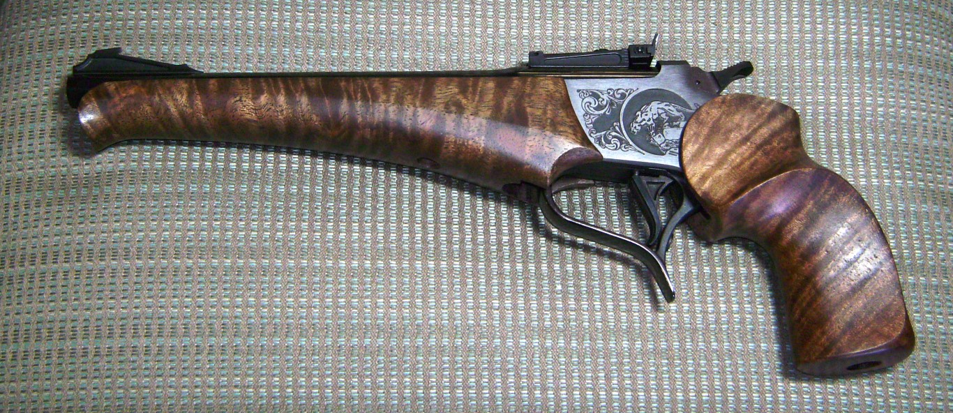

The 221 FB uses a .224 bullet.  The case mouth should be .2245.  I'm partial to the 40 gr. HDY V-Max over 17 gr of Reloader-7, out of my 10" contender.

 What a beautiful Contender. Where did you get that beautiful wood stock for it? I have a couple of
them and several barrels. They are a lot of fun to shoot.

Appreciate the comment.  A buddy who made Guitars in the Ozarks did the inletting and rough shaping.  I finished the fitting and hand-rubbed the tung oil finish.  There are a few folks on the Specialty Pistols website that make similar wood.  If you haven't visited them, you should; great bunch of folks there too: http://specialtypistols.infopop.cc/eve/forums

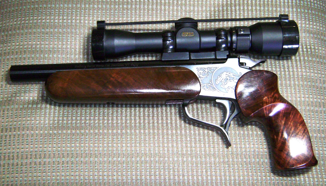

Here's another of my favorite contenders in 17 FB, great squak gun:
Regards, Ron
