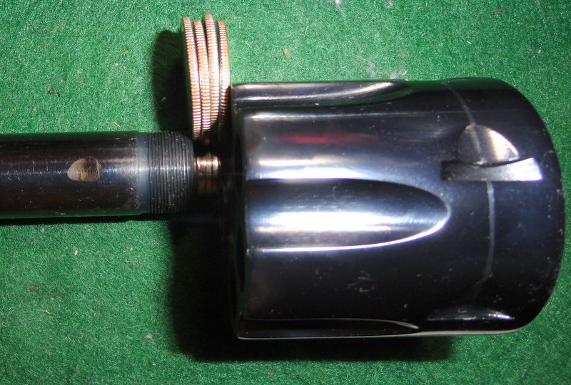

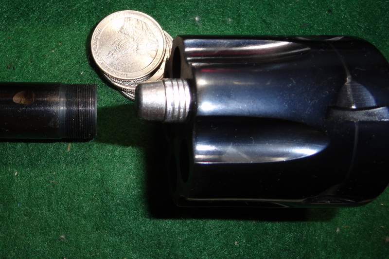

With revolvers, much the same as many rifles, the longer the cartridge OAL, the better.  The importance in "bullet jump" is overrated IMO. Particularly with longer boolits, the front of the projectile has started entering the forcing cone before the backend leaves the cylinder throat.  The critical step is to get the correct size bullet and get it started straight in the throat/ forcing cone/ bore.  With a revolver that is aligned properly, this is best accomplished by seating the bullet as far into the throat as possible, while still securing it in the case to protect from moving under recoil.  That's why I always shrug at folks shooting 38 Specials in a .357... in that case, the bullet may be shaved by the throat before it even gets out of the chamber.  It would even be worse in the maximum's chamber.
Anyway- probably the most important factor in revolver accuracy is its dimensions.  Measurements should be greatest at the throat and least at the muzzle, with no swings back up in any part of the bore.  A funnel of sorts from the rear to the front. This is why some of my Roogars needed a bit of work on the bore.  The frame fitting process often leaves a tight spot that needs worked out by lapping (fire or hand).
I could now go into a diatribe about lead bullets and the importance of lube, bhn, obturation and so forth but that's already somewhere in the DWF pages of history...  anyway- that's what I think I know.
Even with a "One Dollar" gap, the bullet is entering the bore before leaving the throat:
