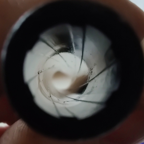

Hi there, I recently purchased a DW .357 porkchop mod 15. Yesterday I decided to dismantle and clean all parts, and noticed that the shroud didn't come off the barrel without the help of my plastic hammer. I noticed the barrel is bulged 1" from the start (cylinder side). I 'm looking for a replacement barrel, 6" version, but here in Belgium (Europe) I can't find any. I mailed CZ-USA, no reply yet. And Eric from EWK Arms doesn't ship outside US... Pitty, I 'd trust his barrels more than the others. Can anyone come up with some help, please? Best regards, Koen

IMG_20201227_132700__01-2.jpgImage Enlarger

Koen, I am afraid there is another problem. Porkchop barrels are 1/4" shorter than the 11 and 12 or the 14-2 and 15-2. They eliminated the exterior nut and just made the barrels 53/4". They occasionally show up on Ebay but you would have the shipping problem. You could have a 6" barrel shortened and rethreaded, or perhaps put a second nut on the end. Have you tried shooting it with the bulge? It may not affect performance. My wife says I am a glass half full guy.
