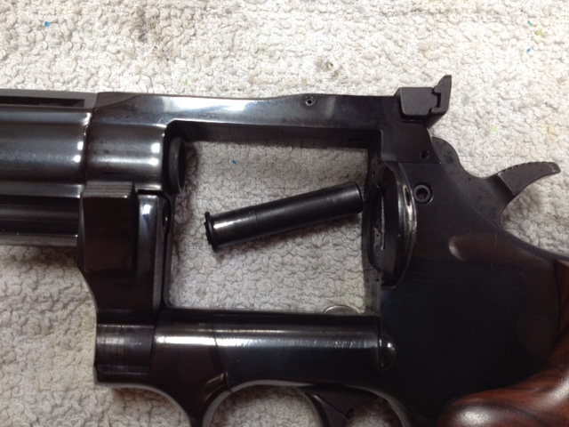

   Last month, after a trip to the range that included my 15-2, I noticed something was not right. After getting home I examined it, and upon opening the cylinder it had a lot of slop. The crane rod appeared cracked, and a gentle tug and it broke right off! The cylinder came right off in my hand. A traumatic occurrence.

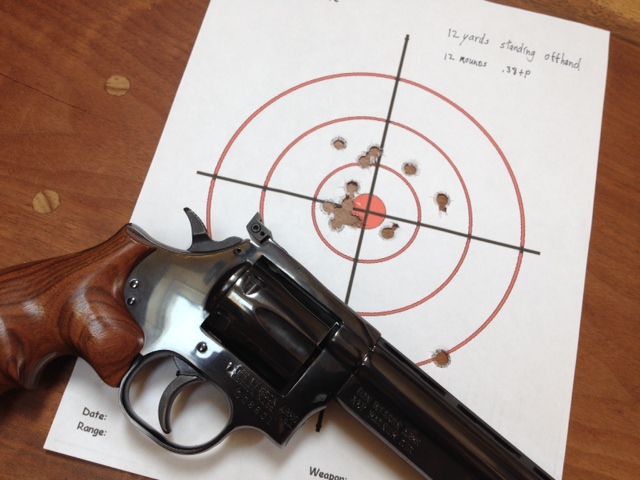

   Took it to the range this afternoon. 12 shots of 38+P for a shakedown run, offhand at 12 yards and accuracy is excellent. (For me). First shot was low and right perhaps cleaning some oil out of the barrel. 5 shots double action were good, like I said the DA pull is heavy but maybe the springs will break in a little after a few range trips. Shot a couple cylinders of .357, groups the same size but a few inches high. Range trip a success and this 15-2 is still a keeper. Excuse the long post this has been an anxious happening that ended up a positive experience.
   Here is a pic of the broken crane
15-2a.jpgImage Enlarger

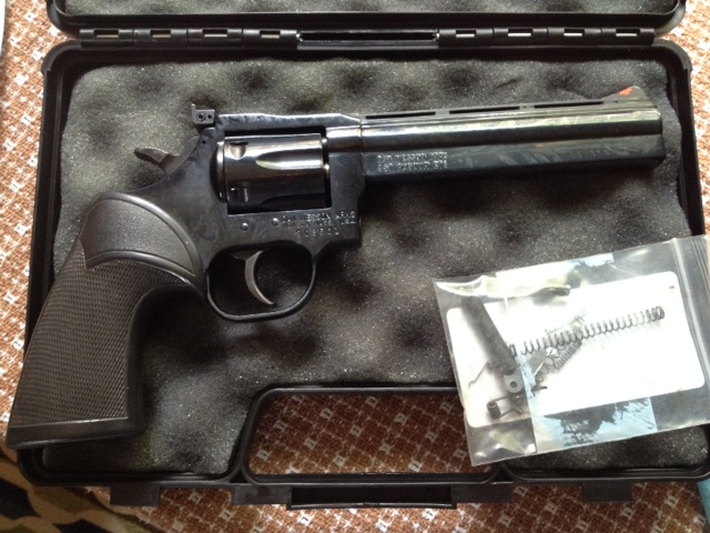

 Here it is back home. I had put an old grip on for the journey. A bag with all the old parts was included.
1.jpgImage Enlarger
2.jpgImage Enlarger
  Range trip, wearing the Hogue grip I put on it shortly after buying the gun3.jpgImage Enlarger
4.jpgImage Enlarger
