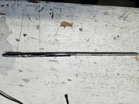

I was loading some 445 supermag today on my Dillon XL 650 and I had a primer chain fire detonation.  About 70 Federal Match large  magnum pistol primers went up at once.  This is only the second time in 15 years this has happened.  Really gets your attention.  Its like shooting a 357 on the basement with no hearing protection.
The first time this happend it was my fault, this time I'm not sure why it happened. I'd been loading for several hours and everything was fine.  There was no sticking, no excessive force, they just went BANG!
I'm going to be calling Dillon tomorrow  for a new large primer system.  The only damage i can find is the inner aluminum primer tube is ruptured,  but Dillon replaces the entire assembly.
The only commonality between these incidents is they both happened using Federal large primers.
I prefer Winchester or CCI but in today's market, you don't always get a choice.20250223_180906.jpgImage Enlarger

Primer dust and static electricity could be a possibility if you didn't feel any resistance. Patch the tube occasionally and keep an eye on the feeder area as well.
February 24, 2025 - 6:37 am
That's a good idea Ron.
I'm still unsure why they went up this time.
I'm going to tear the press down and replace the entire priming system with new, also going to realign the platform and verify timing.
At least the ballistic steel tube contains and directs the blast up and away from the operator.  Other than ringing ears, nothing  happened to me.
Sounds like the usual suspects.... I make sure the press is well electrically grounded (manually operated or motor driven) and use a static ground strap on myself (like when working on electronics). The grounding strap can be a bit of a pain but is long enough that I can reach most things I may need during the actual loading process.

Is it possible that some primers fell into the tube facing each other? Two with the business end facing each other may have bumped each other & fired off under pressure, then fired off the next few up the line?
I don't have a system like that. I intentionally hand prime only, so I can get a feel of an irregular one coming into the mix & to make sure one doesn't go in backwards. But I also only reload a few hundred at a session, maybe you guys are into the 1K area?

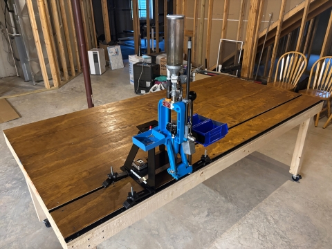

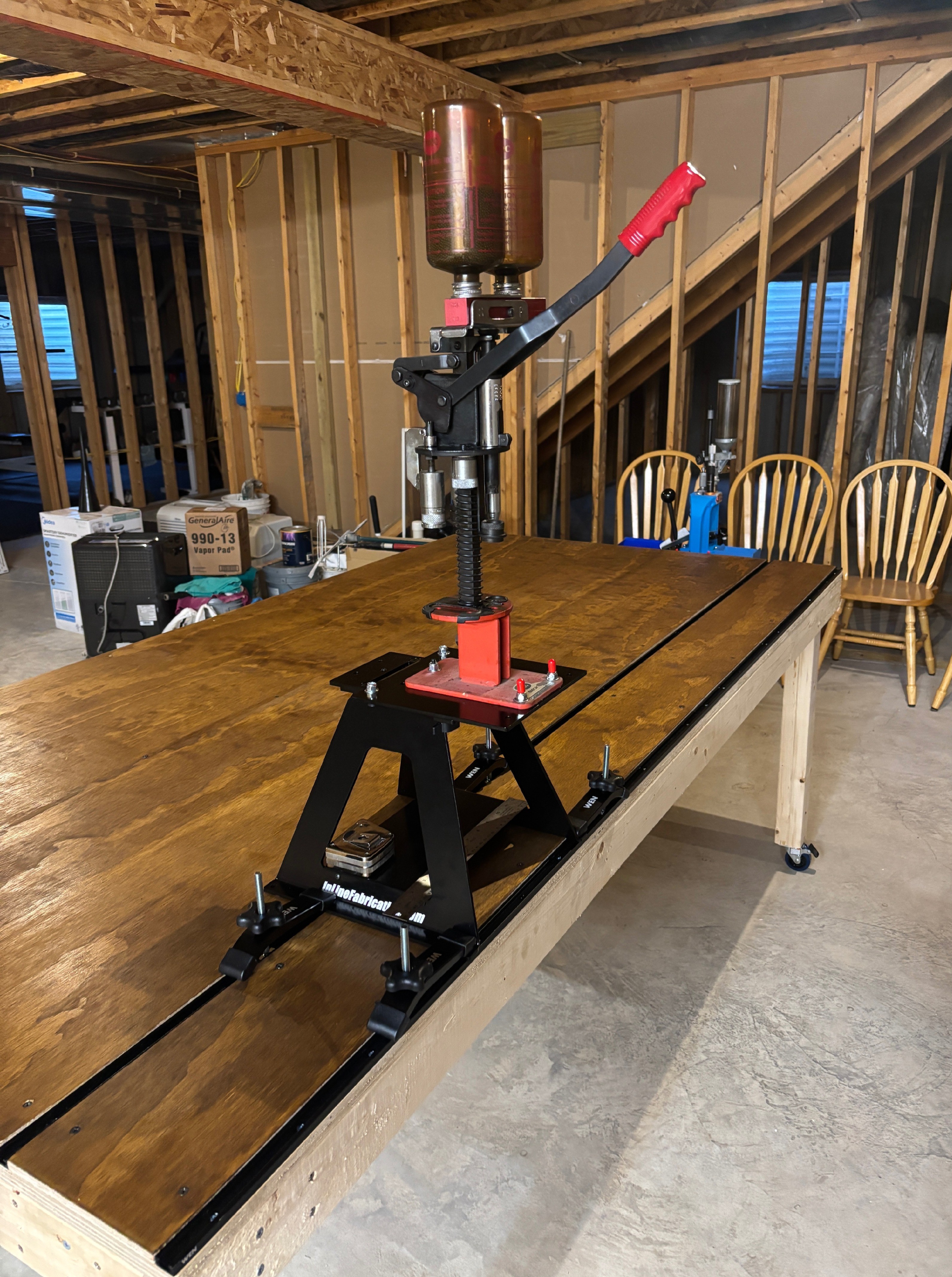

I just completed building a new reloading table.  Well, I do have a few more tasks to complete before it’s fully done, but it’s far enough that I can begin using it.  Also invested in some InlineFabrication quick-change mounts to allow me to swap out my Dillon RL550 and MEC 600 Jr.  That system works great.  I don’t know why my second pic decided to rotate 90-deg clockwise. (fixed it- rwsem)

If you study such phenomenon...and SEE (blown up Guns) .. you will find that Invariably..they were loaded on a Progressive
March 1, 2025 - 10:41 am
I run a powder check to prevent double charge and no charge situations, never had that issue.
The design of the Dillon 650 primer system makes it prone to chain firing if one primer goes off.
Federal primers seem very sensitive to accidental detonation also.
The 750 presses changed the primer system to help stop the chain fire issue.  I'm considering switching to a 750 since all my dies and tool heads will swap over.

Good looking table. Are you going to make some shelves to attach to it too?
Man, I wish my basement was that empty again! It was fairly empty before my 2nd wife came along...then we lumped all the crap from her house into mine & damn!wow
