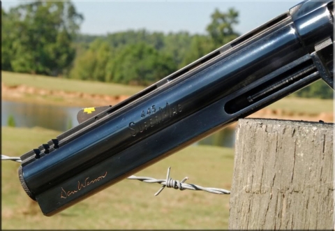

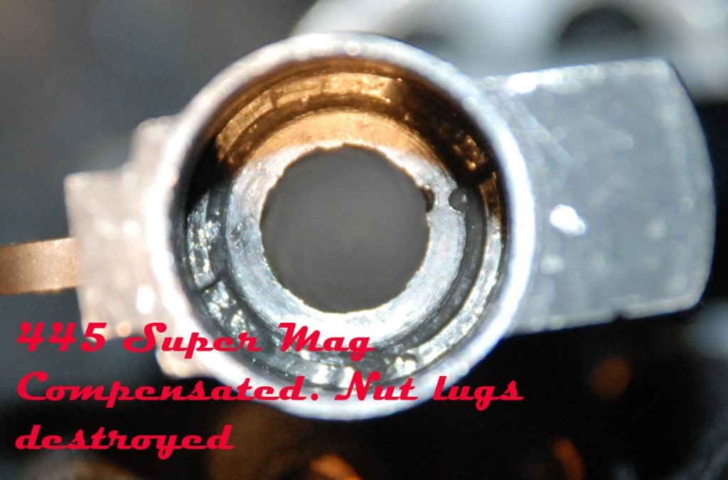

Here is a serious stuck barrel nut. In a .445 SM. With a muzzle brake.  It took an L.B. to get it out. L.B. is the man. The barrel was recrowned and the threads were touched up by the fabulous EWK.dw15wg.jpgImage Enlarger
DWlug.jpgImage Enlarger
DWnut2.jpgImage Enlarger
445recrown.jpgImage Enlarger
