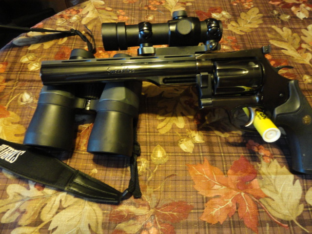

This is my first,I got it in trade for a ruger 6" 22 markll from a dealer here,apparently he didn't think ya could get dies for it,which I got from CH4D and when I told him I got a set he just had this I just got screwed look on his face. I also came with a aimpoint 2000.50 piecs of 375sm brass,ammo box and a shoulder holster which doesn't fit to good due to the aimpoint. It is hard to believe that all this hassle with the blowback was caused by the rest,I have no clue why that didn't dawn on me. I'm thankful that the  folks here got me back on track. My brother does casting so I might get the mould to try useing in this fun to shoot DW. I will have to try and get a picture up.occasion

Here it is,not the best but covers most of it. It is in my mind that sooner or later I'll be passing this along and get started on something else,hate to this thing is alot of fun to shoot but just cost more for the amount I like to shoot.
