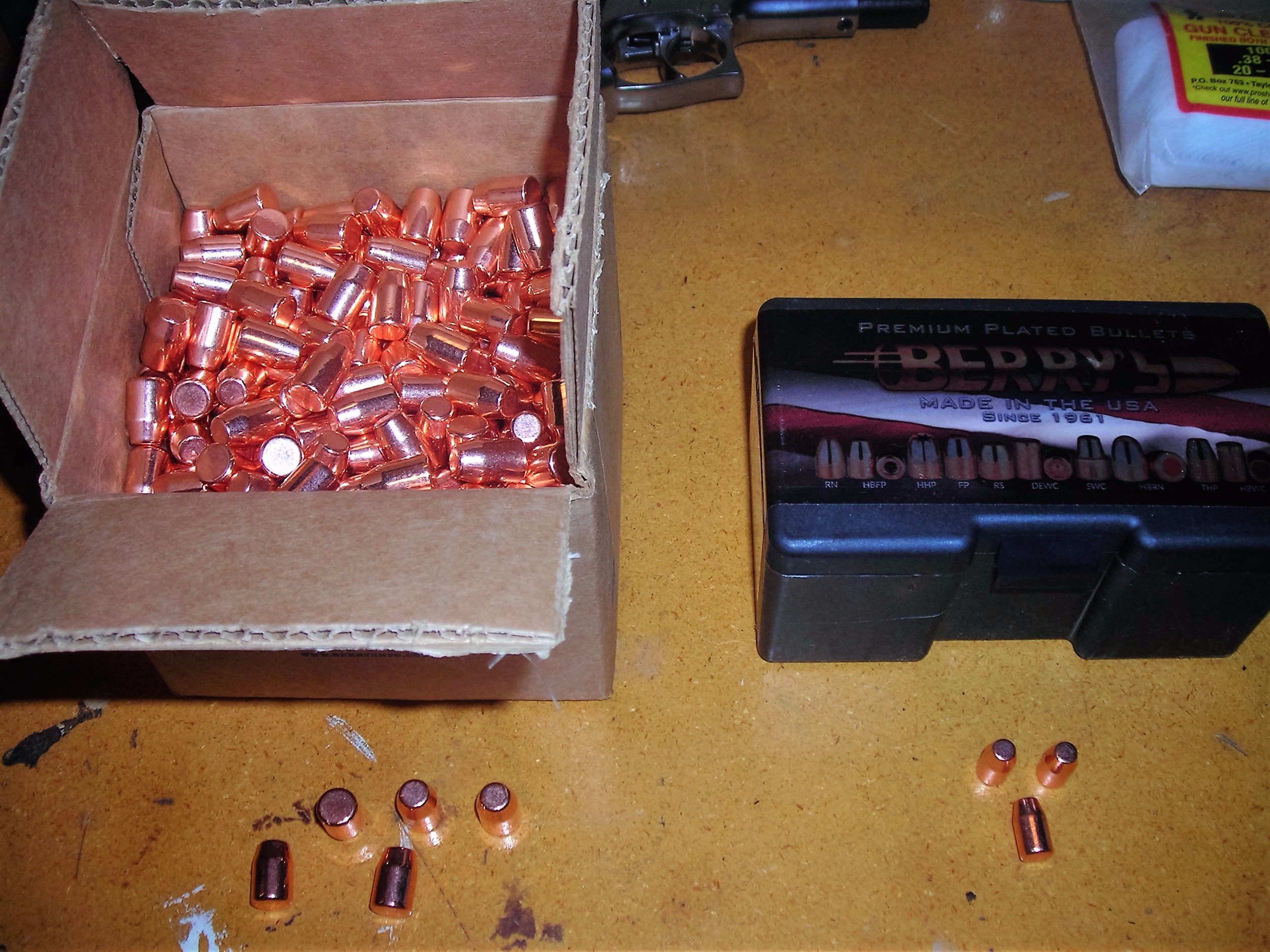

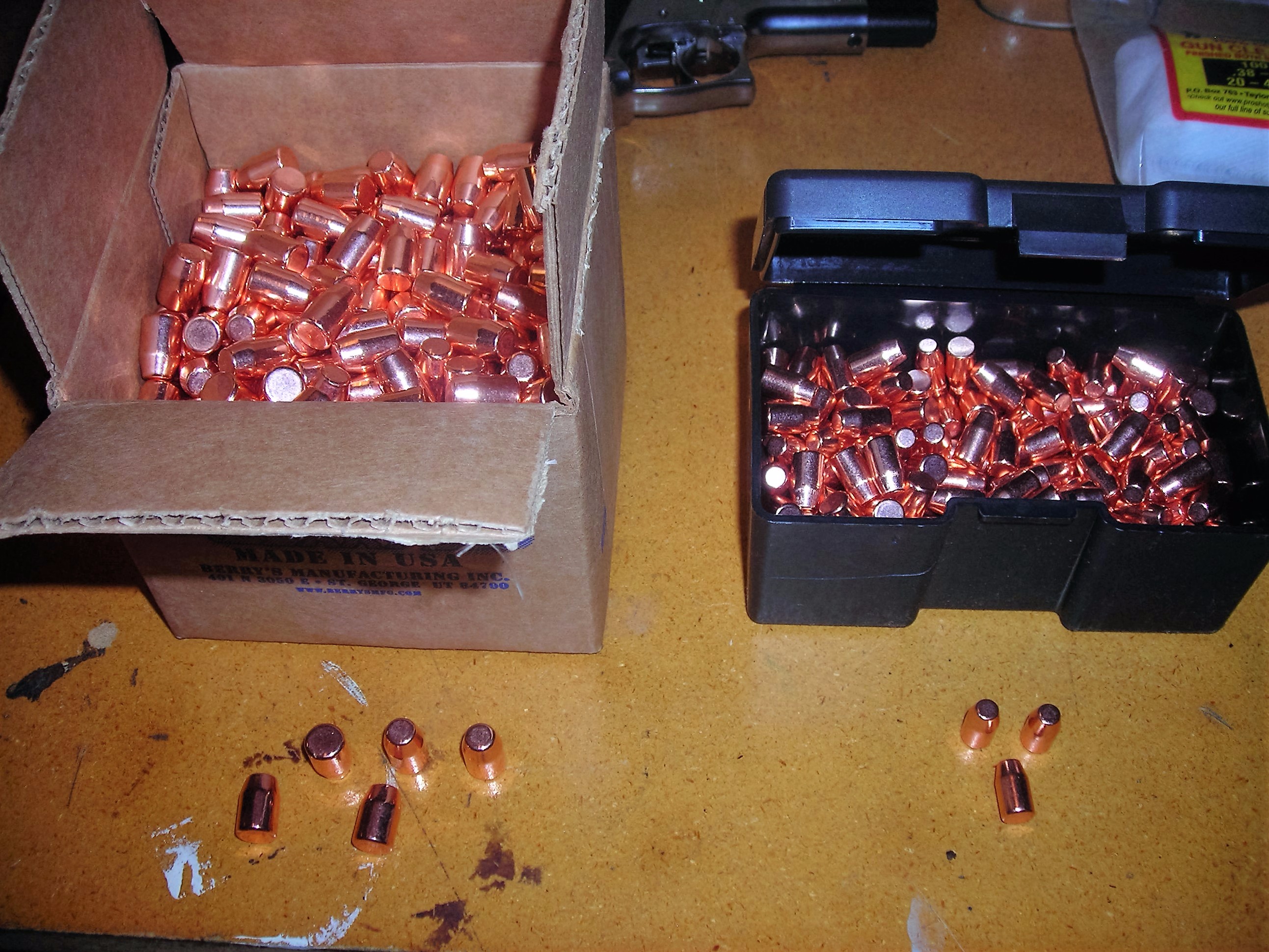

Got some 158g 357 Berry's bullets from Midway a while back and used most. I found their site online and got some more
the other day w/some 240g .429 also. Free shipping w/$100.00 order. The 357s worked great.
The 44s say 1250fps max MV ?? This is fine for smaller loads, but if I go over that, what's going to happen ??
Is the bullet going to come apart ? I used Nosler in 445s already and got these for Henry 44 Mag.confused
