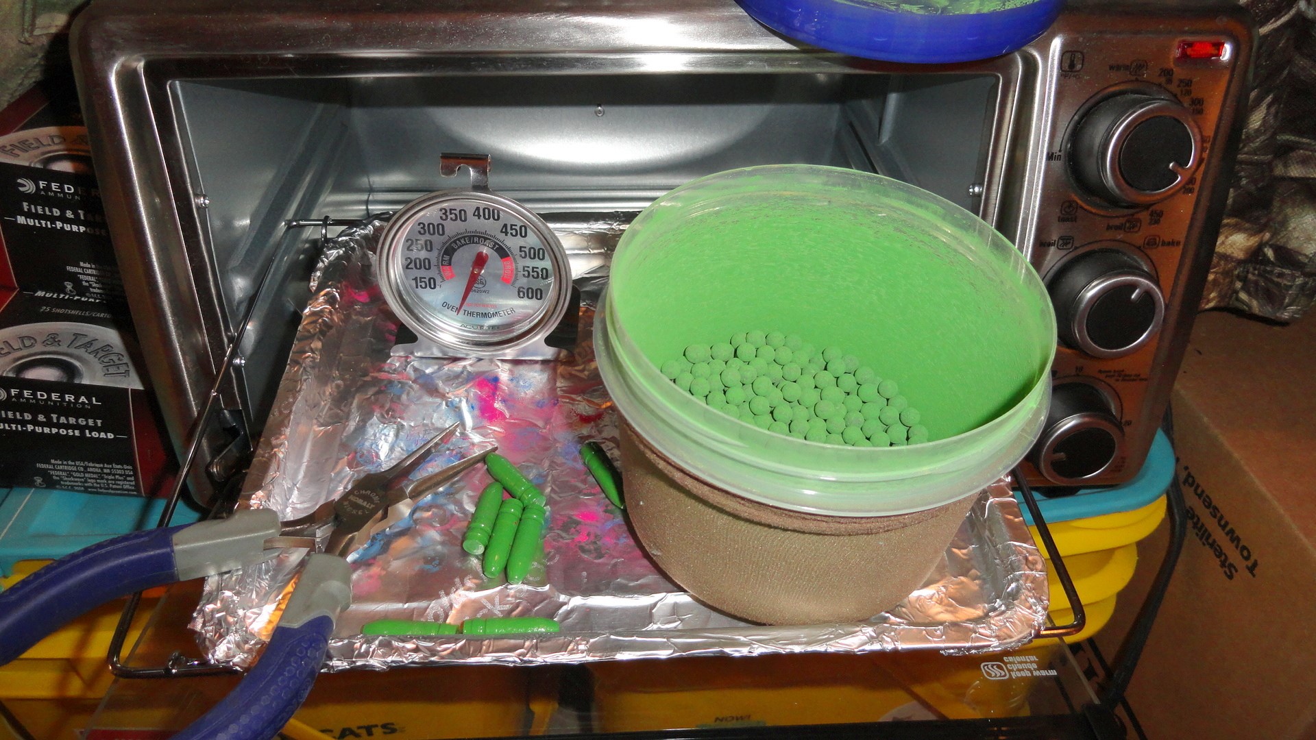

Been baking my own for a while:
DSC01335.JPGImage Enlarger

Ron, is that an Easy Bake Oven?
December 30, 2016 - 7:36 pm
Black and Decker toaster oven from Wallyworld... shake and bake and I helped.....
