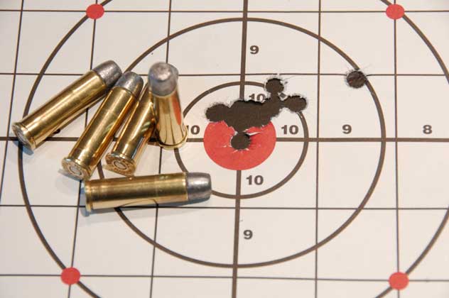

Return to an old thread.
After a few months of loading and shooting I have settled on 12.4 gr of 2400.
Group sizes really settled down with this load.  The Lyman manual gives 12.5 gr max for a 195 gr cast bullet so it should be safe.  No sticky cases or flattened primers.  Recoil is very manageable compared to my 45 colt.
This is 10 shots at 25 yards from a rest.  I'm pretty sure the accuracy of the round has far exceeded my ability to shoot straight so I'm staying put.  DSC_0748.jpgImage Enlarger
There was one flier but still good enough for a medium critter/invader.

January 5, 2014 - 1:49 pm
Darn good shooting pardner!
