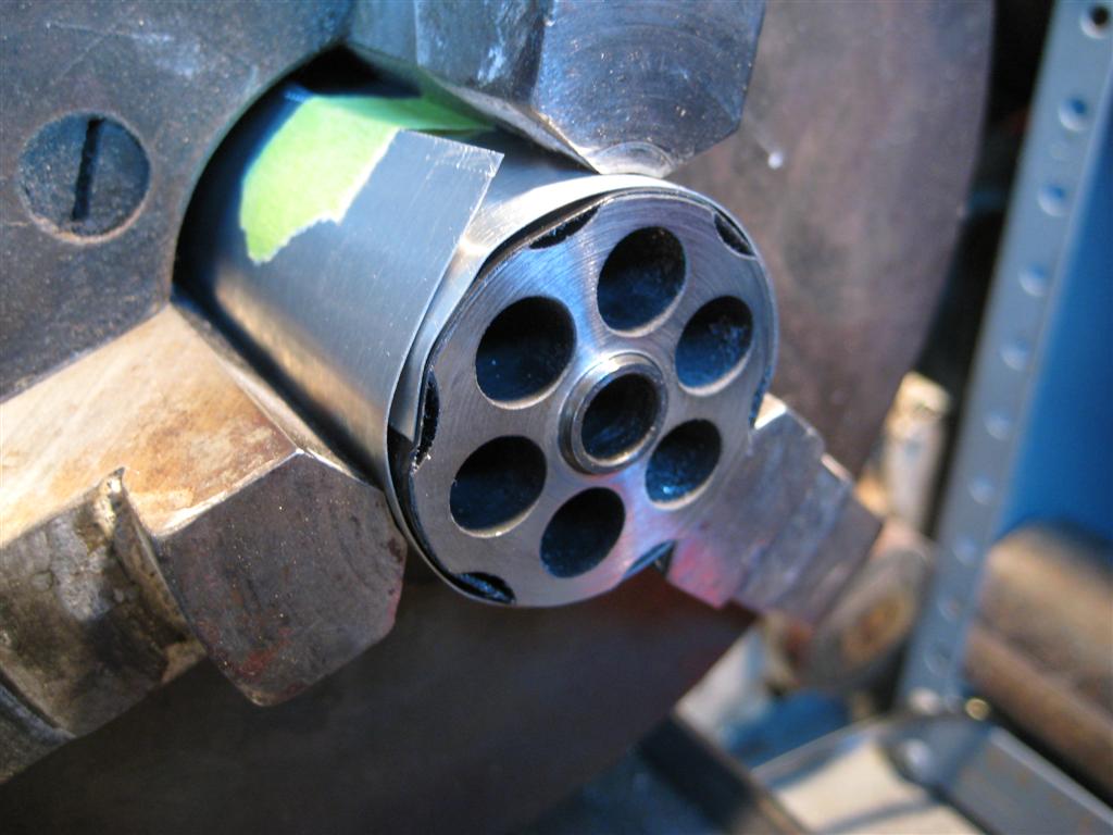

I picked up another 15-2 to tinker with Laugh... It is in great condition except for a little endplay in the cylinder.
The barrel/cylinder gap was uneven more than usual, so it was time to play.... Out came the lathe.
I faced off the cylinder and was amazed how uneven it was--no nice smooth cut, just a chunk, chunk, chunk as it only hit on one side of the cylinder.  I also hit the forcing cone end of the barrel with some emery cloth on a machinist plate to square it off.
I put a final polish cut on it and it looks perfect now.  All my cylinders are within  about .001" now.  If it wasn't for the endplay, I think I could get it even closer.  I may have to play with the cylinder ball pressure a little bit.

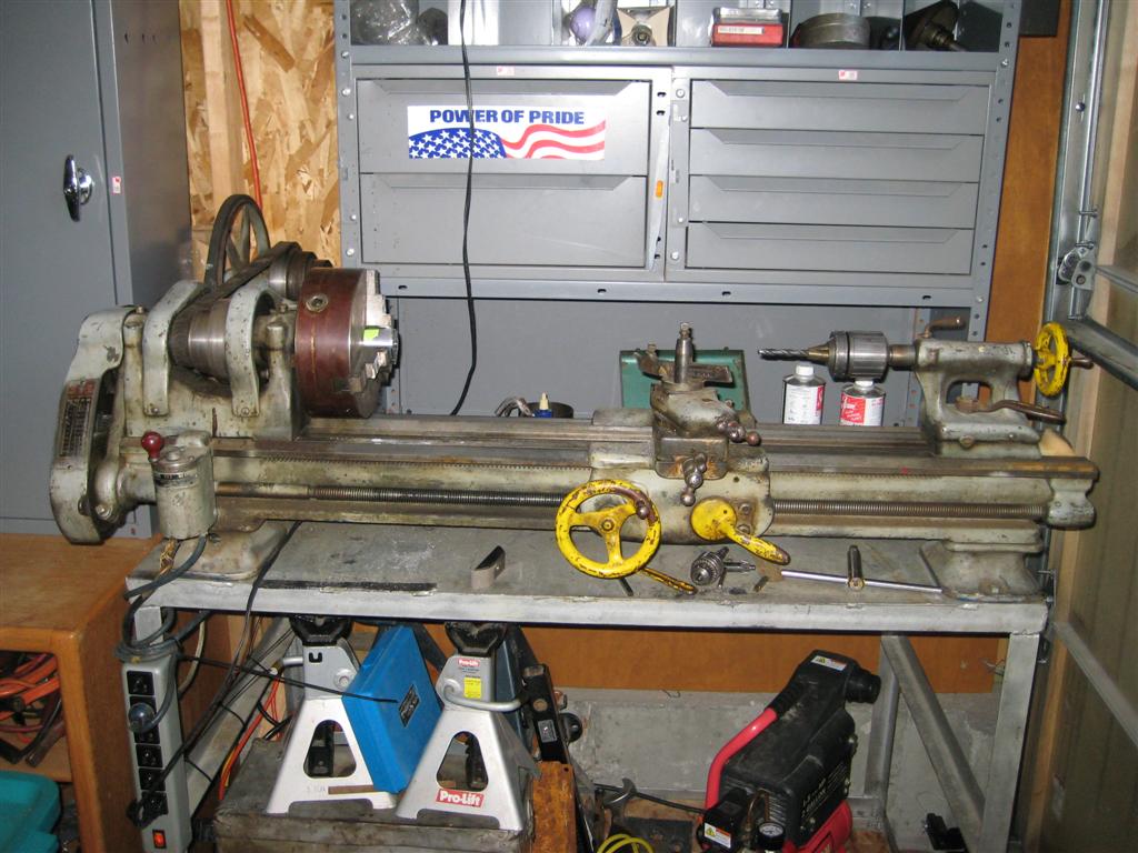

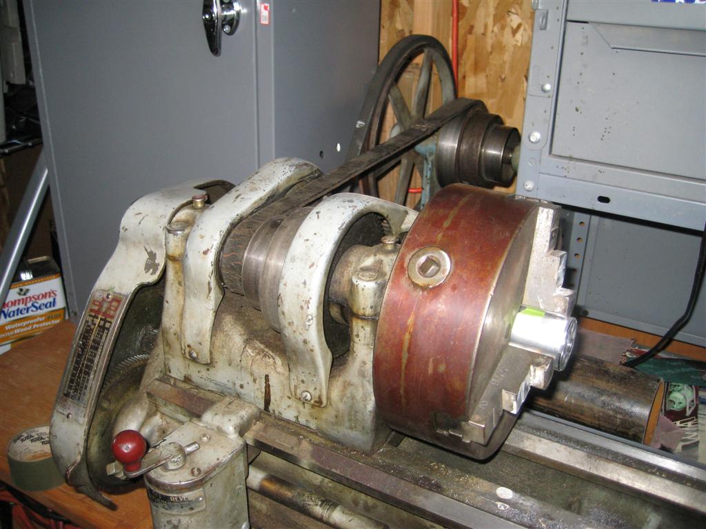

As long as the camera was out, I figured I'd show you guys my "high tech" machining equipment Wink...
Here she is, roughly 1937 era .... old, but gets the job done... kind of like me !

I LOVE the high tech environmentally friendly colored adhesive, same color I use for just about everything. Big Grin
  Nice lathe too. Everyone needs to have something to play with when the WIFEWife

Shoot, that's a great way to true-up a cylinder!occasion

I had planned on doing a full restoration on the lathe a while ago... but, it seems like there is never enough downtime.  I'm into electrolysis for rust removal/restorations, so I could make it look like new.  Maybe this winter I'll start tearing it down.
