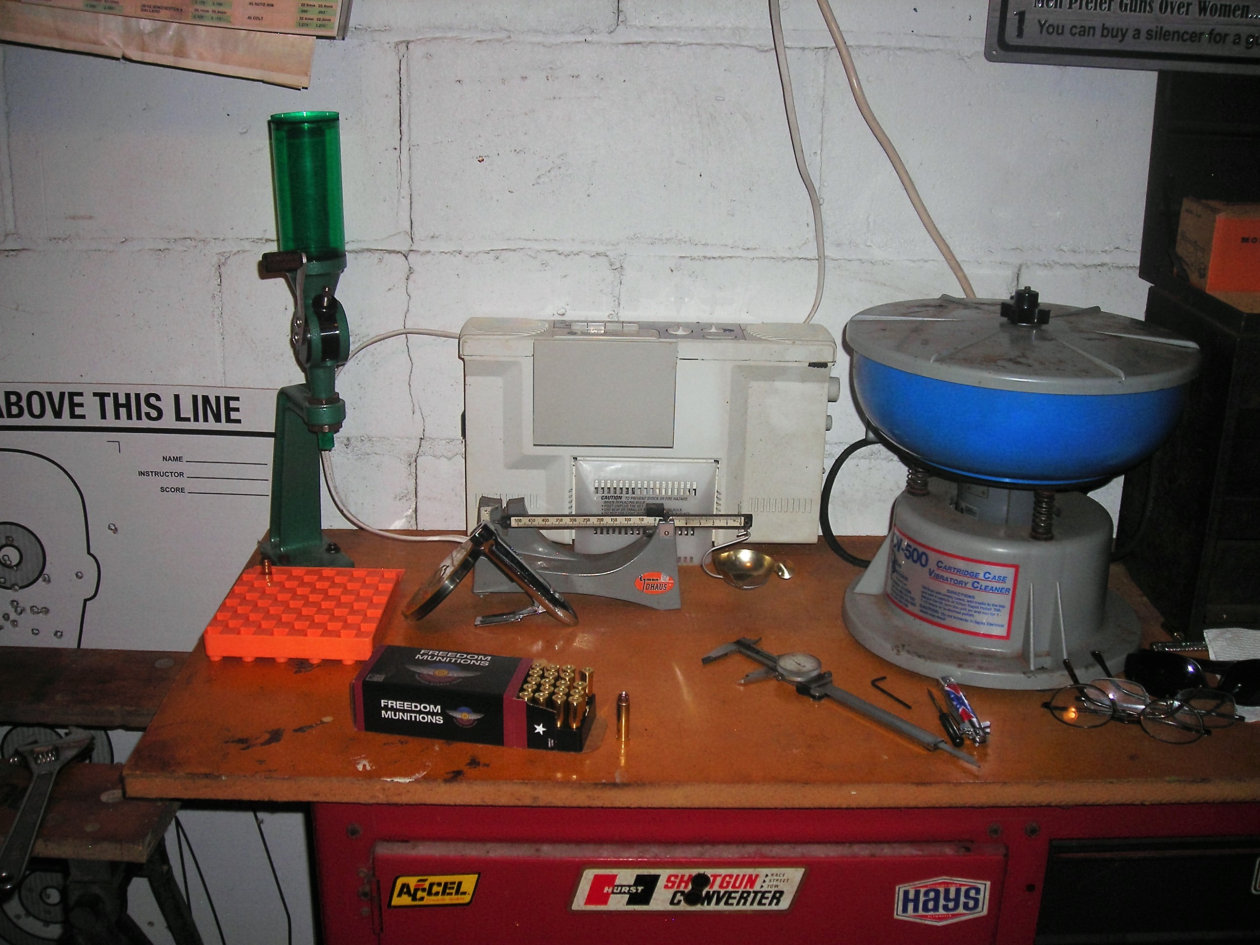

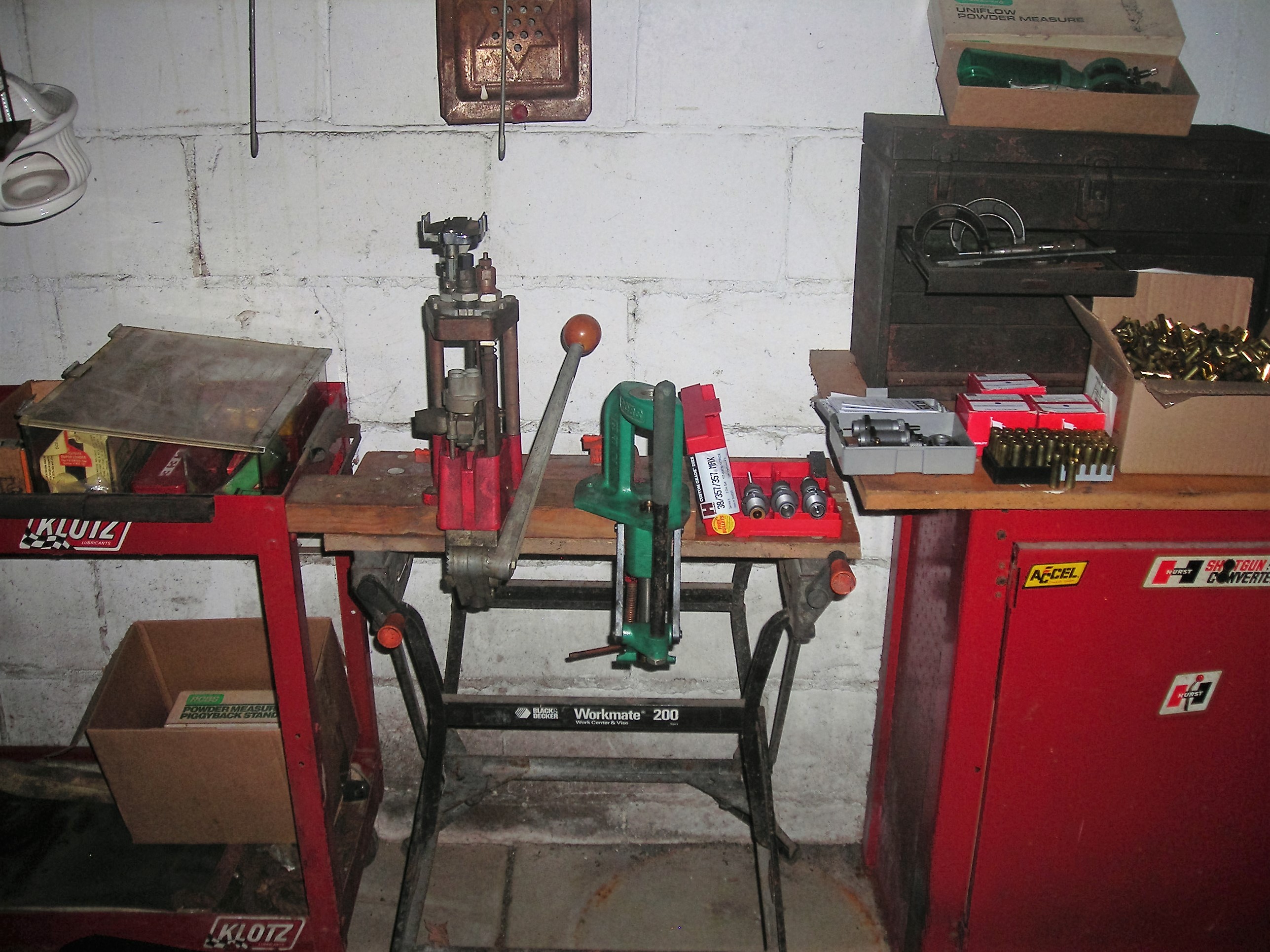

Here's my setup, got stuff all organised and comfy, well lit, tunes winkcool The Dillon shaker is the bomb !!
DSCN1384.JPGImage Enlarger
DSCN1385.JPGImage Enlarger
DSCN1387.JPGImage Enlarger
DSCN1356-1.JPGImage Enlarger
