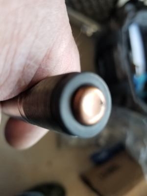

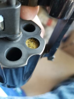

I traded services with a reloader for 500 rnds of 357 max...(no problems on first lots) and
WE knew something was off when on some loads went "poof" instead of "Bang", and we were getting unburt powder out of the 0.002" gap, bouncing off stall walls and peppering up in the face.   But, we were hitting the target @ 15 yards.    This round jammed in the barrel and fortunately locked up the cylinder.   The pictured cartidge had blown back and primer had grabbed the firing pin.   Had to disassemble the 357MAX to eject cylinder.    Pictured.
The 445VS8 was a recent purchase and only previous shot was 44mags.    This day was 44mag loads, 360(?) grain bullet in .445 cartridges.   The primer on the 4th-5th shot has grabbed the firing pin and locked up the cylinder.   I may have been getting flame from cartridge-end of cylinder...(primer), but do not know for sure.      I was able to remove the lockring, but shroud will not come off...stuck on the pin that aligns the shroud.   Rubber mallet has not loosened it.   Advice on removal without breaking the pin?
Different Topic: I scrub the cylinder bores of my 357MAX with brass brush and CLP cleaner the day before shooting because the spent cartridges have a tendency to stick when being ejected.   I did not dry the cylinder bores thinking the CLP would aid in spent cartridge ejection.    Is it possible the the heat from the cartridge being fired and the CLP cleaner residue creates the problem of difficult ejection?

I speculate that the charge contained deadened propellant from cleaning residue at base of cartridge and only the primer's pressure seated the bullet into forcing cone
Dowel rod with smartly smacked by mallet from muzzle to remove lodged projectile

If you get a cylinder hone same caliber or size as your cylinder and run it in and out 8-10 times per hole your stuck case days will be behind you, they are available for 20 -30 usd on ebay. And shooting other people's ammo is always a risk, you find out soon enough if they knew what they were doing. Glad your all ok.
