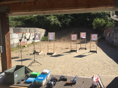

After some back and forth with another member here, I started my 2400 load test using 20 grains and my home cast 265 gr Keith bullet.  The goal was to come up with a reduced load for the 445 that would allow more trigger time without the hard recoil of full power loads.  Here's our setup at the range....
range-setup.JPGImage Enlarger
445-test.JPGImage Enlarger

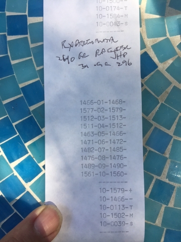

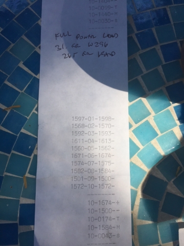

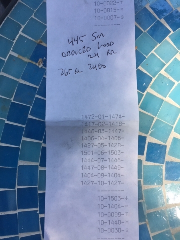

Here's the data tape from the chronograph.  The first one is my 24 gr of 2400 load, the second is 31 gr of W296 (also under the same 265 gr cast bullet, and the third is 31 gr of W296 under a 240 gr Rainier plated JHP.

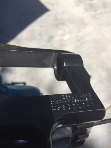

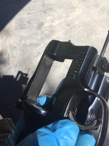

The 2400 load shoots well, recoil is manageable, and accuracy is good to very good.  The 296 load however, is giving my some problems.  It was very flashy, recoil was a bit harder, and then I noticed what can only be flame cutting on my top strap.  Here's a couple pictures...
445-frame.JPGImage Enlarger
445-frame-2.JPGImage Enlarger
It doesn't seem very deep, but there won't be any more firing of this gun until I get it figured out.  At the moment, I feel like just dumping 296 altogether.  I'm figuring that there could be another cause for flame cutting as well, namely that the barrel wasn't gapped right. I used a feeler gauge that came from EWK when I got a new tool set for my DW .22 revolver, set it pretty tight.  Tomorrow, I'm figuring to order another tool set for the 445.
I also notice that the extreme spreads and the standard deviations on all three loads are large.  I think that this is due to using a powder measure and an electronic scale to throw charges.  It may be that I need to throw a charge and then trickle to exact weight just as I do with high pressure rifle loads.  Loading for this caliber is definitely proving to be a challenge!

Suggest that you double check that the visible flame cutting is actually eroding into the steel and not just a carbon buildup.  Several times I was convinced my topstrap was being eroded but thankfully so far it has always turned out to be just carbon.  Good luck sorting out the new toy!

Yes its a bit of a cut. Enough to catch a fingernail. I think it occurred when I was shooting the 240 gr bullets with 31 gr of W296.

Been searching the inter webs for info on flame cutting of the top strap and everything I find points generally in the direction of running light bullet loads with max powder charges.  In the case of the 445, it may be that the 240 gr bullet is a bit light, and combining that with a heavy charge of 296 (H110), which is a "flashy" powder, produced the above cut in my frame.
The cure (at least for me) is 1. no more 296 powder loads, 2. no more light bullet loads, 3. no more max charge loads, 4. constant vigilance over the cylinder gap.
