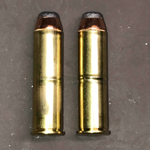

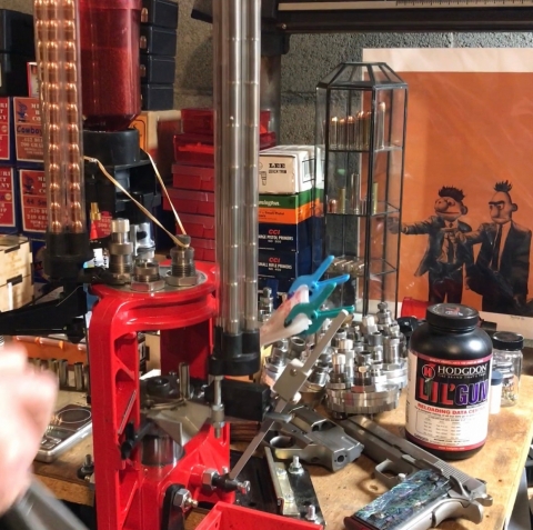

I’ve just started reloading for my 445 supermag in my Lee Loadmaster using new starline brass and 300gn Hornady JHP. I immediately got case buckling in the Lee 44mag/445supermag factory crimp die. I have the die adjusted about .34” higher than 44 mag and slowly adjusted the crimp screw but as soon as I start to get some crimp the case buckles. Even with that there’s still not enough crimp. Any help would be appreciated.
I have been reloading 357 mag/supermag, 44mag, 45 LC, 454casull, 500mag, 50beowulf, and 45/70 with no such problems. I have some ideas, but would like to get other opinions first. I always use collet crimp dies where available.  There are none for the 445.

This picture shows my general setup. (pic of .357 magnum loads )

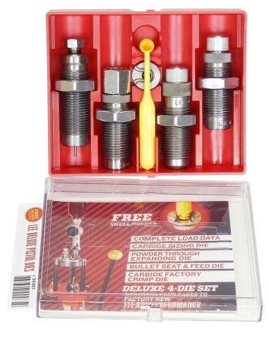

It is a lee carbide factory crimp die:
Lee 44 SPL Pistol 4-Die Set. Includes Carbide Full Length Sizing Die, Bullet Seating Die, Powder Thru Expanding Die, Carbide Factory Crimp Die, Universal Shell Holder, Powder Dipper and Instructions/Load Data.
Note: These dies can be used to reload 44 Magnum and 445 Super Mag.
https://leeprecision.com/reloading-dies/hand-gun-dies/lee-carbide-factory-crimp-die/
This is the set for 44sp/44mag/445supermag which I am using.
https://leeprecision.com/4-die-set-44spl-carb.html
reloading-set-pic.jpgImage Enlarger
I have ordered a Lyman 7153105 Taper Crimp Die for 445 Supermag in hopes that will solve my problem.

I had a bulge issue when I reloaded ETG 445 brass. It bulged near the bottom. I switched to Starline brass and the problems went away. I do use a Redding taper crimp die. When I purchased my gun it included 4 dies. I used the taper crimp because some where I read it was the best crimp for hard recoil guns. The taper crimp would probably be the best crimp on plated bullets also. A heavy roll crimp can sometimes crack the plating which is not a good thing. The 4 die Lee sets I have basically crimp the very end of the bass to factory mouth diameter. Good for semiautomatic pistols. If you go with too light of crimp your bullets will pull out under the heavy recoil. I think the taper crimp die you ordered will fix your problems.

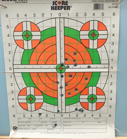

Here is a target from the range today. 445 Supermag both 240 and 300 gn JHP bullets at 25 yards and no scope. I was pleased  with the results and there was no bullet jumping in the cases. I did not adjust the sights yet.

Can I ask your powder of choice and charge weight? I am curious what primer you used also. I think you will be surprised with a little tweaking how your group is going to shrink. You are already looking good for your first time out. You just need a little muscle memory on the trigger squeeze. 4” groups will be there shortly.

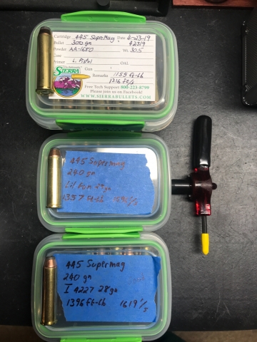

Actually those were a mix of three:
300gn JHP and 30.5gn of AA1680 1316’/s 1155ft-lb
240gn JHP and 29gn of lil’ gun 1596’/s1357ft-lb
240gn JHP and  28gn of IMR 4227 1619’/s 1396ft-lb
all with large pistol CCI primers. Velocities and kinetic energy were estimated from formulas on Ammoguide.com
