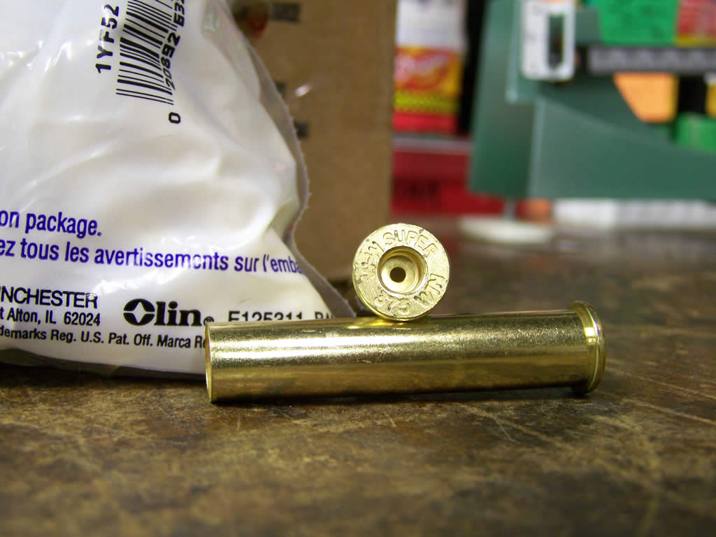

I just got a bag of WW Super 375 WIN brass. It has to be cut down for the 375SM and I have no idea how to do that. Hack saw??
Here's some pics of the brass. Is this the right stuff?
July 8, 2010 - 7:22 pm
I use a fine tooth hack saw to convert 30-30 cases into 30 Herrett brass. There is a die you run the brass up in and saw along the top of the die, then trim the brass to spec. I don't know about 375 but I am sure one of the guys will jump in soon with all the right info.

Harbor Freight has a mini cutoff saw that works great. It's on sale for 25 bucks. The guys over at SP love it for wildcats. You get the length very close and true up the case with your case trimmer.

I'm  at work so pictures are out of the question. but I have been using a forester case trimmer for 20+ years on 375 winchester bras and 30 herret, match sizing any 44, 445sm,357m 357sm, etc works good! there are other manufacturers so skip the hack saw buy the trimmer and pilots aa drill can be mounted on the crank handle or if money is not an object they do have powered units. check e-gouge and good luck!occasion
