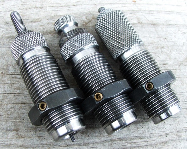

Hi all,
Just found RCBS 375 SuperMag dies on the interwebs.
s-l1600_R.jpgImage Enlarger
I think they'll do.
Now I need to hustle up some boolits and I'll be in business.
Warrenbig-grin
April 7, 2016 - 5:28 pm
Be sure to lube the cases, they are tapered and 375 SM dies are not carbide so require lubrication.

Gotcha, Scorpio.
Picked up some Lube at Eastern Outfitter's last week. I have loaded rifle ca'tridges in the past but it will take a paradigm shift to make sure I lube the cases.
Also I think it'll be important to completely remove the lube before firing them. With that tapered case I want to avoid any chance of the cases being setback against the recoil shield and locking up the gun or causing sticky ejection.
Watcha think, y'all?
Warren
(I have experience loading and shooting a S&W Mdl. 53 .22 Jet and those are the kind of issues you can have with that too.)
April 8, 2016 - 12:26 pm
It's definitely a good idea to wipe the lube off once they are loaded. I've found that once the bullet has been fired, any lube that was left on the case makes a gooey mess in the hot cylinder. Sticky ejection will happen for sure, in that case.
Congrats on landing those dies, they aren't easy to find!occasion
