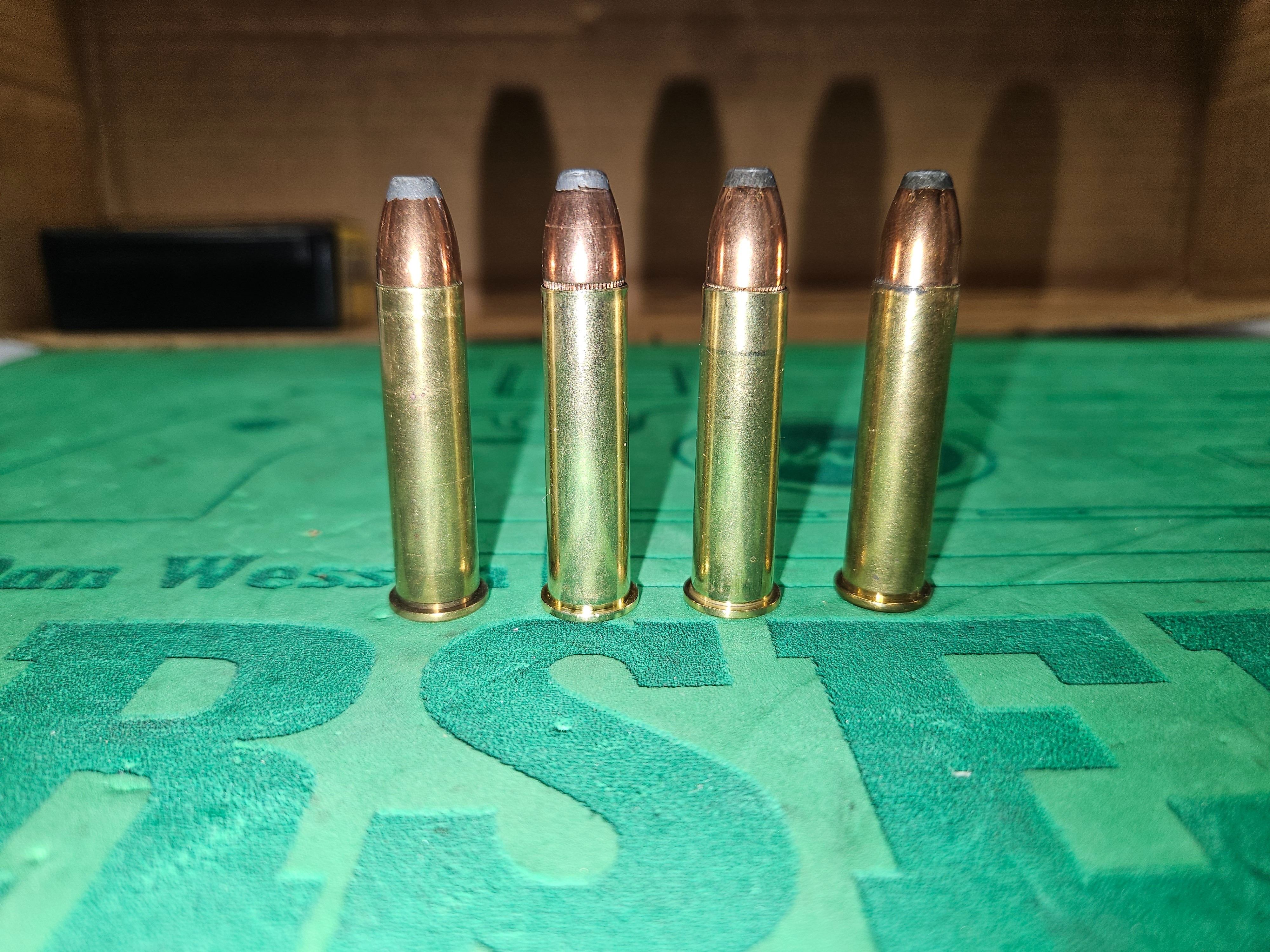

February 18, 2024 - 4:58 pm
375 conversion Family photo.
Left to right,  30-30 winchester, 38-55 Ballard Starline brass, 375 Win Starline brass, 375 Supermag IHMSA headstamp.20240218_144044.jpgImage Enlarger
