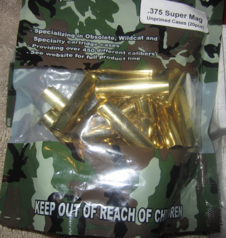

Just wondering if this brass I bought from Quality Cartridge since it's already sized properly would not cure the sticking problems. I know it's expensive (around $2.25 per casing but you're reusing the brass over and over so once you buy say 100 casings you can reload them over and over again? Anain i'm no expert and even dumber when it comes to re-loading!IMG_4177-2.JPGImage Enlarger
