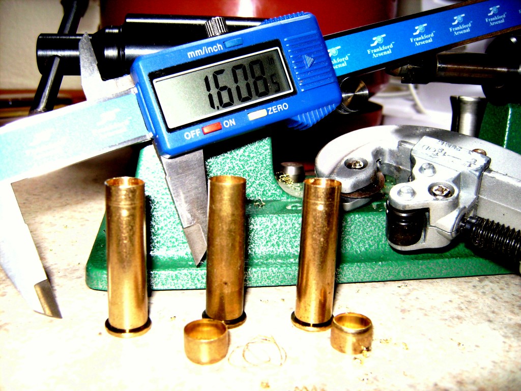

After reading several posts about 375 SM Brass, I've decided to have a go at showing my method for making 375 SM Brass from 375 WIN Brass:
Select and lube the 375WW brass.

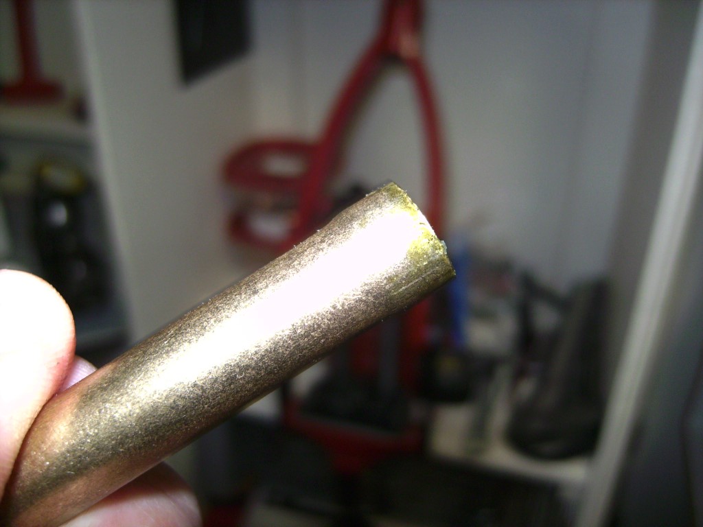

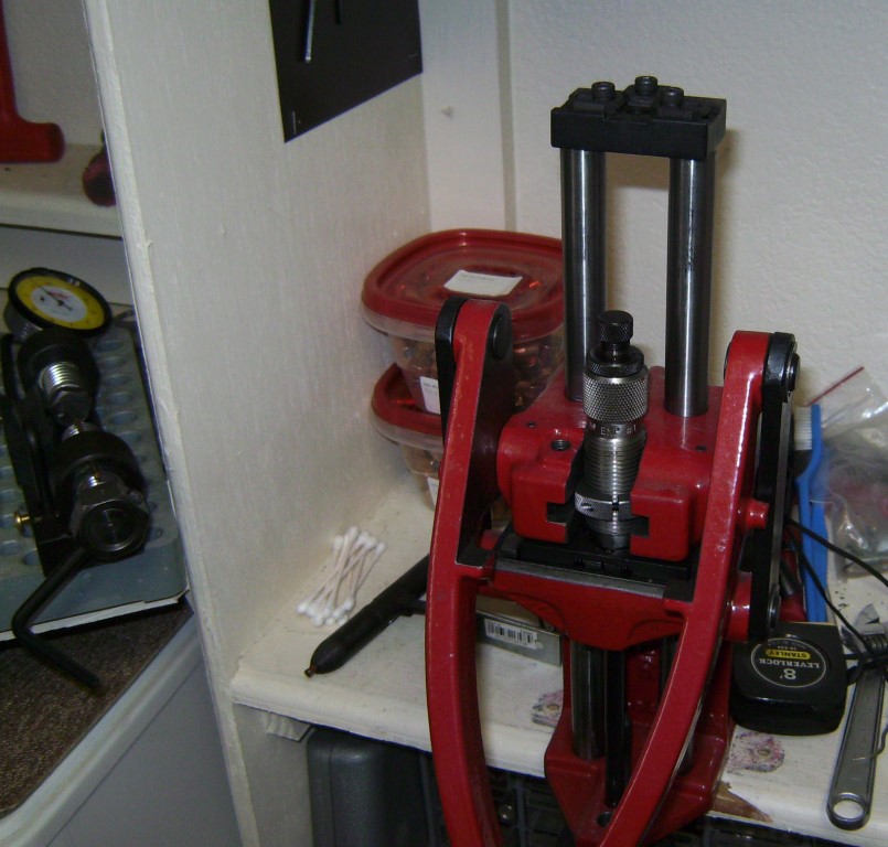

Run brass all the way up the expanding die, notice the bulge after expanding; it's OK, that part is removed.

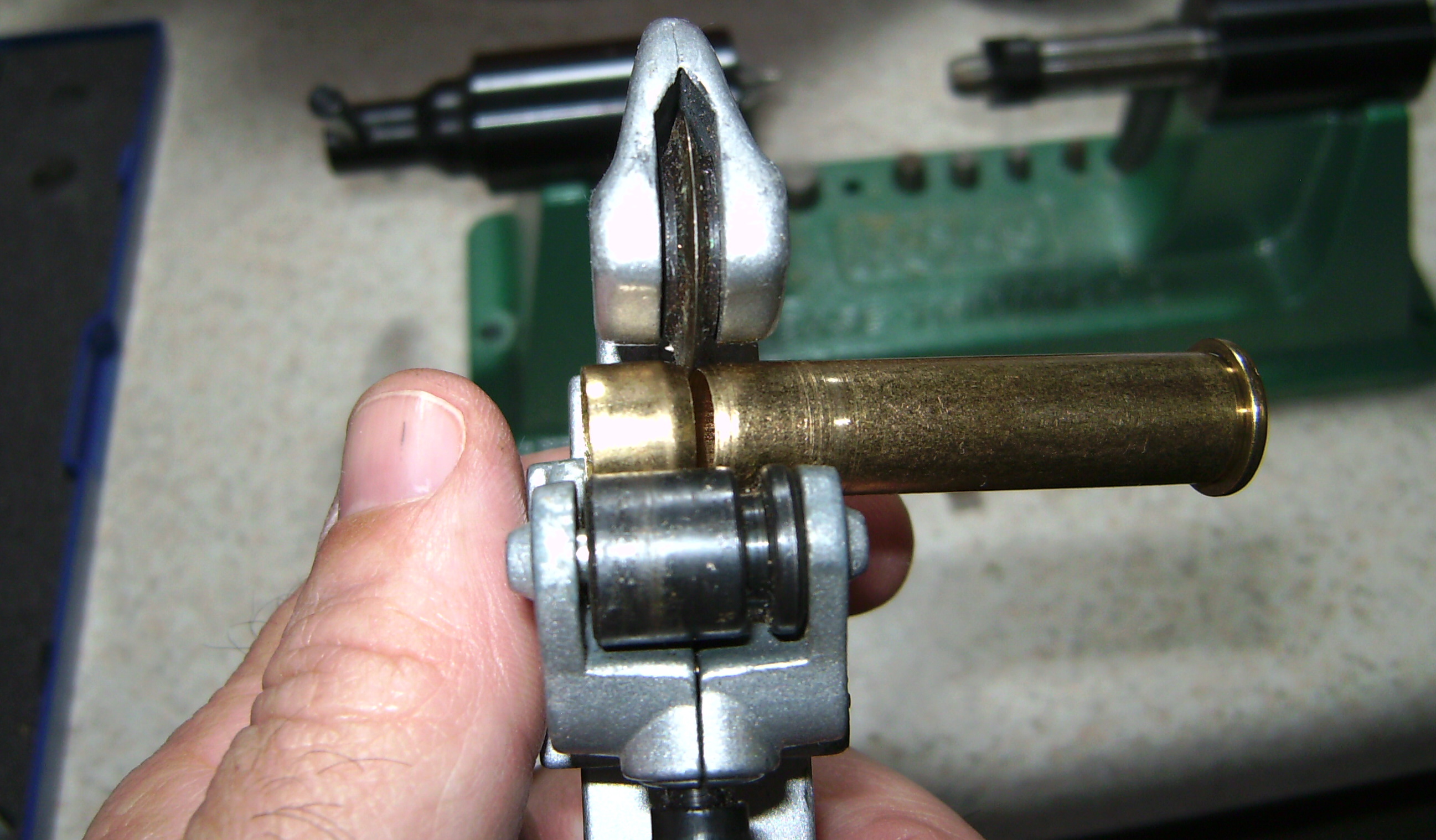

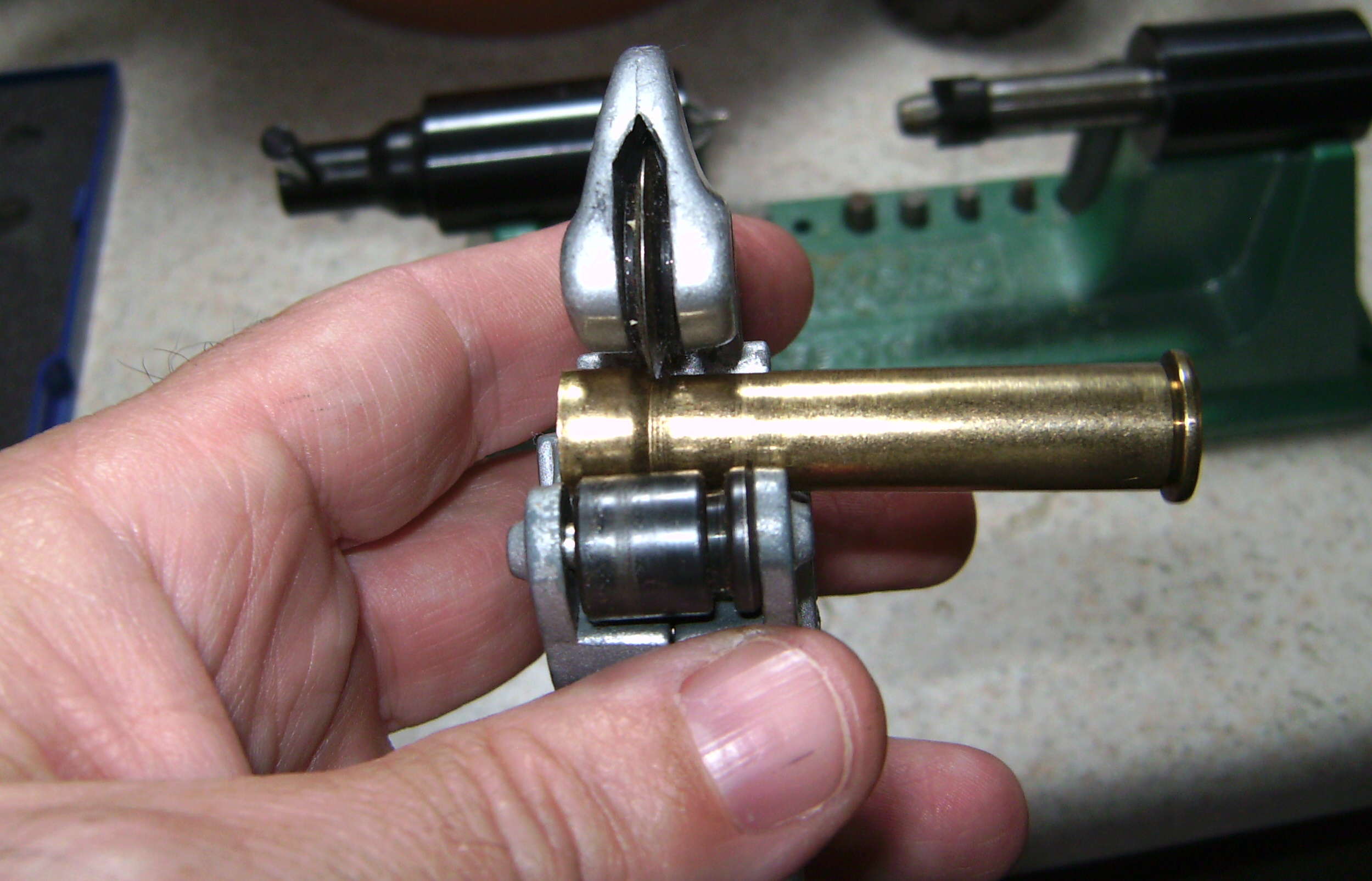

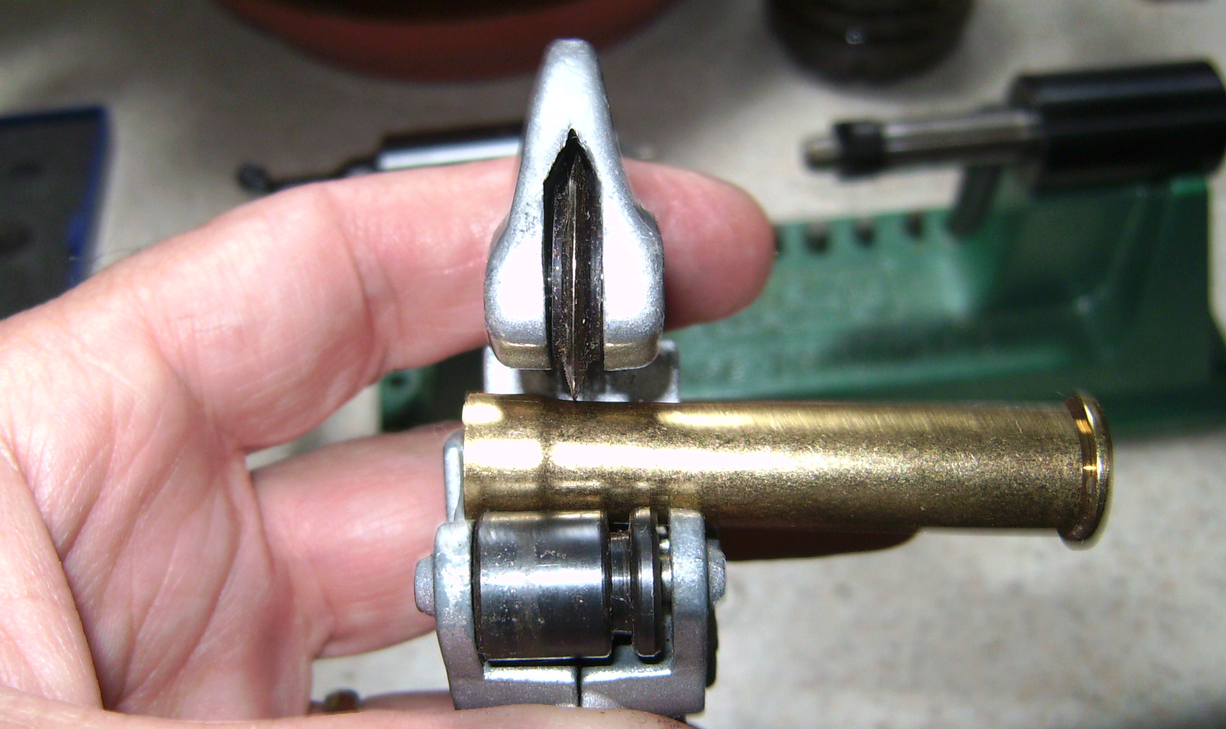

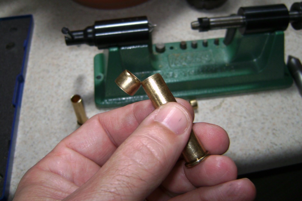

Using a copper tube cutter (I used to use a dremel), place the cutting blade under the bulge and start cutting; SLOWLY.  You don't want to crush the ends too much.
Run the cut brass through a deprime/ resize die.

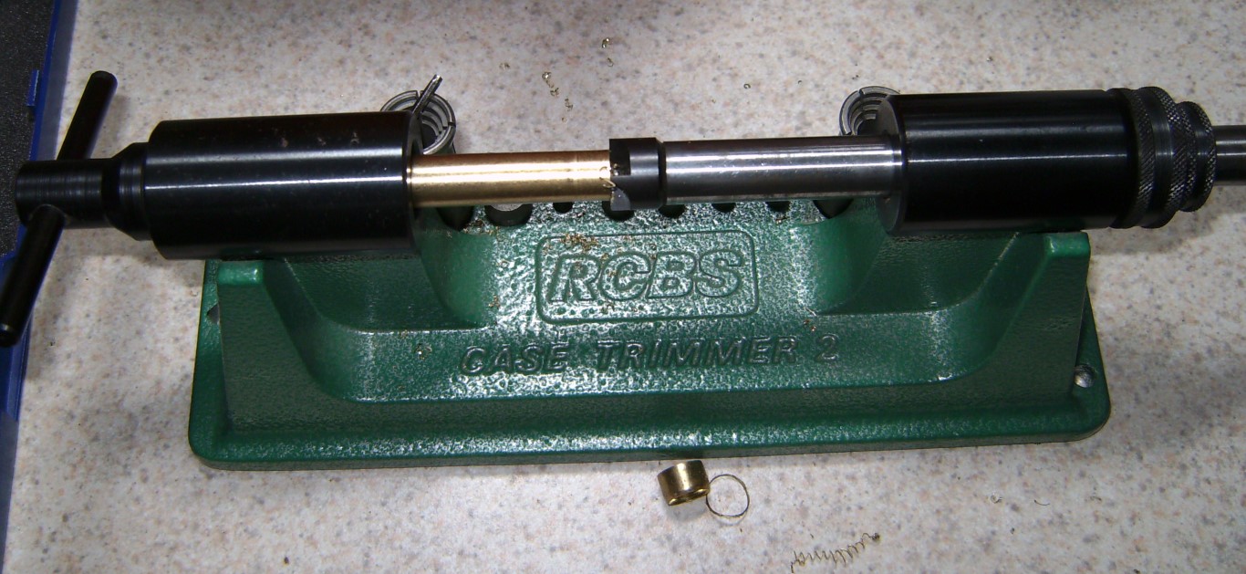

Trim to length on a case trimmer.  If you don't have one, get one.  You'll need it eventually if you reload.
Check to ensure the length fits your chambers.

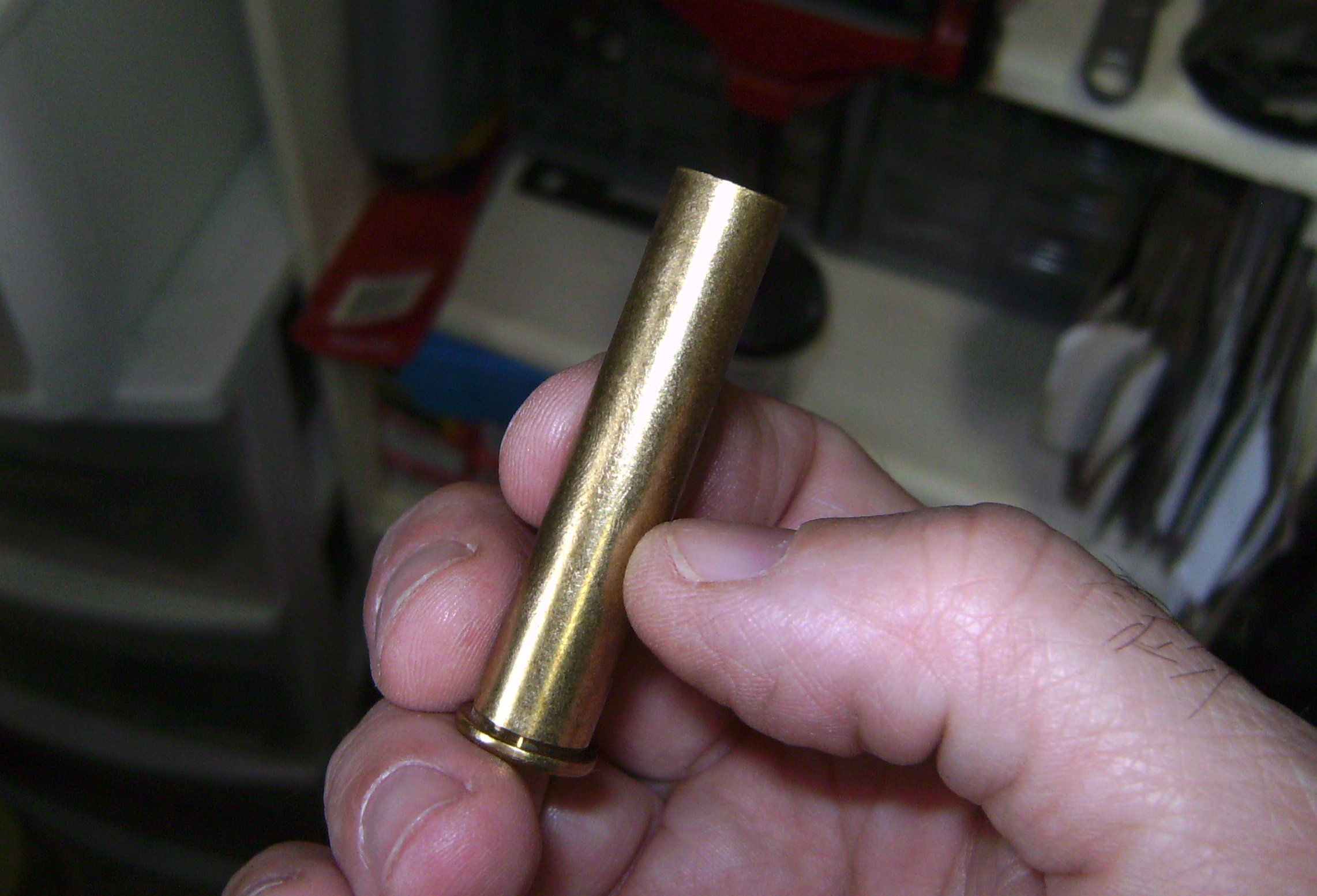

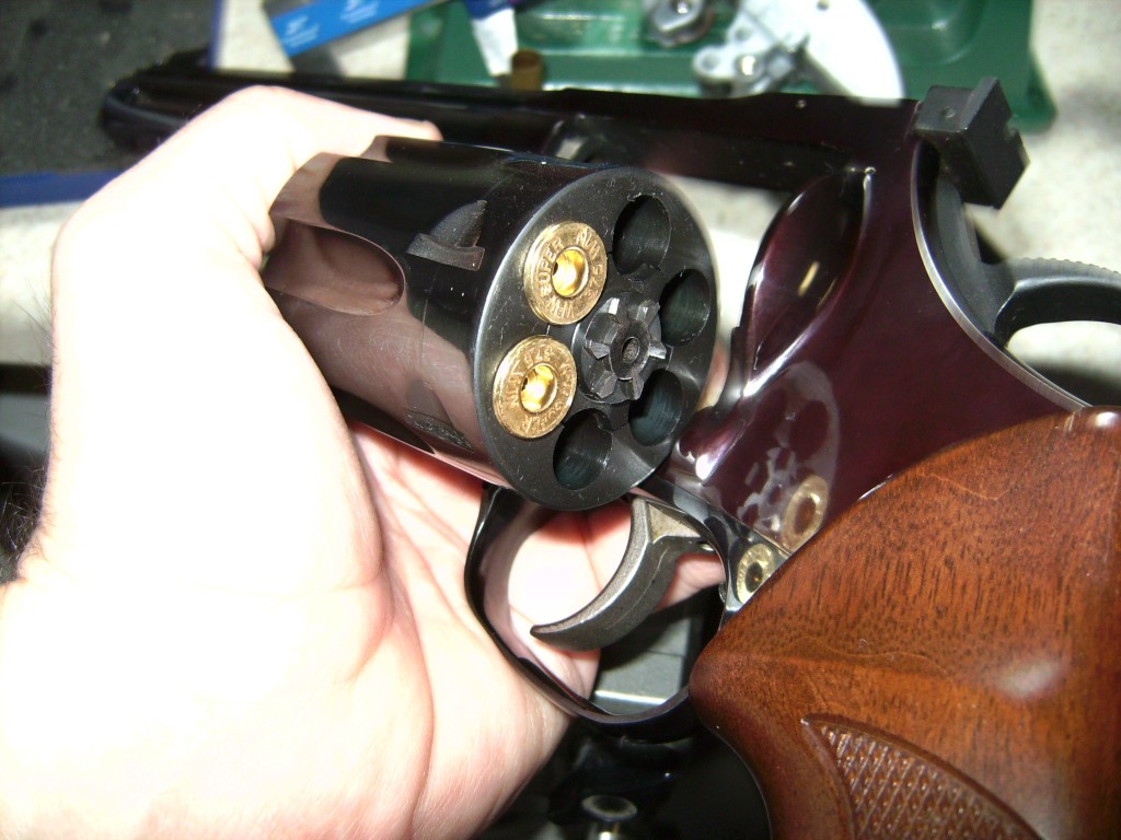

The center piece is IHMSA 375 SM Brass, the outsides are cut brass.  Now you're ready to reload….

That seems so simple, why didn't I think of a tubing cutter?  Is that forming die a special die?  If so, where do you get them?  Is that just the resize/deprime die you are using for forming?
March 18, 2012 - 12:33 pm
Not a special die, just the second of a three die set.  I guess it's actually the expanding die.  I'll edit the post.  Probably an unnecessary step- I just run the expander down to near OAL for a guide… I suppose you could just mark the brass and start cutting.
Thanks.
Edit: FWIW; I just finished trying to cut brass without expanding first.  What I discovered was the brass would get crushed a bit more during cutting and then the mouth on a few (2 of 5) would cave in when expanding to fit a bullet. I'll stick with my original method.
March 18, 2012 - 6:48 pm
That's a nice tutorial Ron, thanks for taking the time to do this!dwf-sign
I like the tubing cutter idea, although I'm surprised the cutter wheel doesn't try to "thread" the case, due to the uneven case diameters where the rolling wheels are concerned.
In any event, it looks like it works nicely.occasion

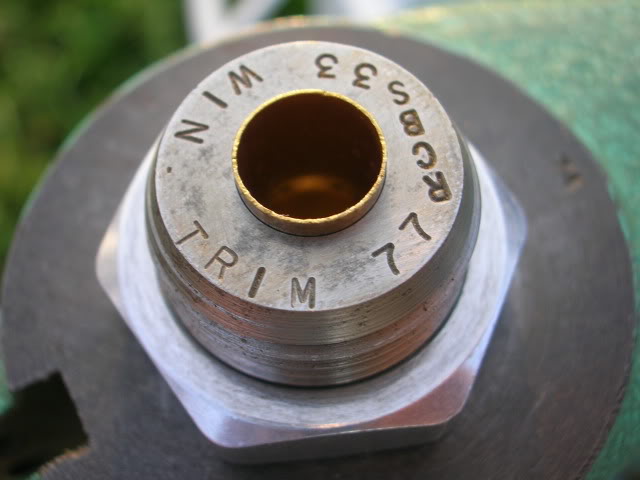

File trim die?
March 19, 2012 - 10:20 am
Yes there is a file trim die for the .375 SuperMag. One of my die sets came with one.
March 19, 2012 - 7:54 pm
yep, I have a trim die, but not until recently.  That's why I used the dremel and now a tube cutter...
