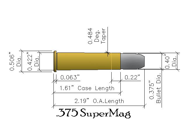

April 6, 2016 - 10:25 am
Done, Mr. Scorpio!
Let me know if I can take any further actions, OK?
Here's something I drew up to see if I understand what we are trying to achieve.375-supermag-dimensions-1.jpgImage Enlarger
Thanks,
Warren
