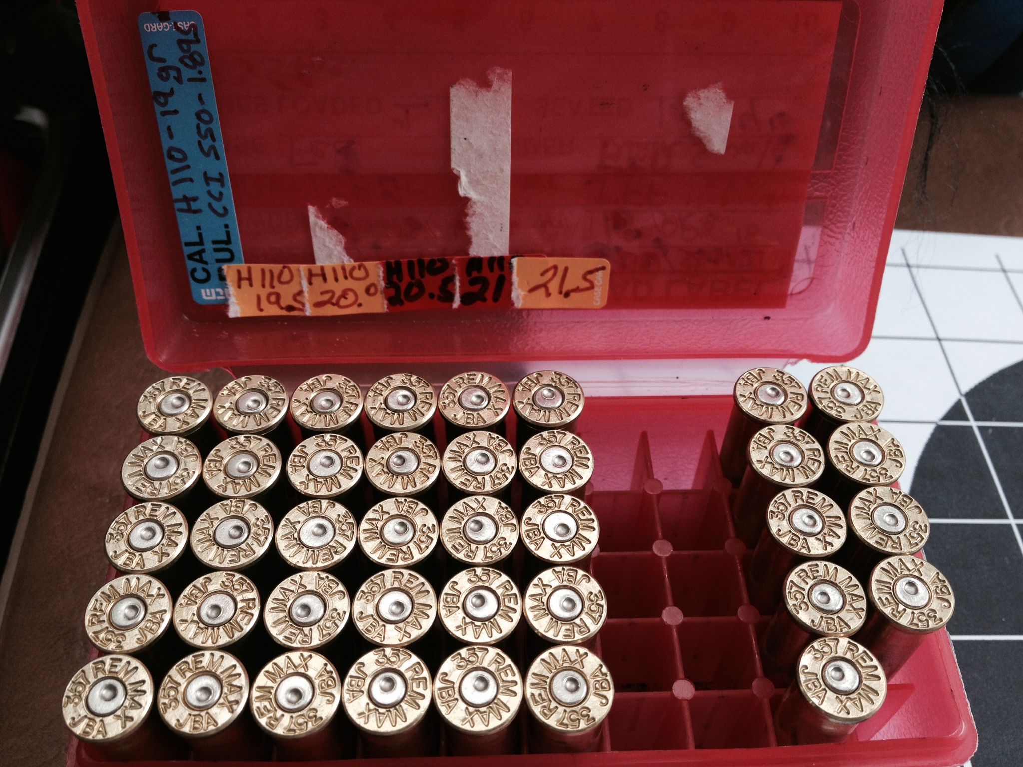

Using the Jamison 357 Maximum Brass and CCI Small Pistol Magnum primers for 30 rounds I am ready for another day at the range with the 357 Super Mag and the chrono.  I have also loaded 9 rounds using Federal Small Rifle Primers and 20 grains of H110.
I loaded 5 rounds of each of the following and the OAL is 1.895" - The 180 grain Hornady XTP have two cannelures which is nice as it will allow a longer OAL and no compression of the powder if the loads get that full.  I also used a Lee Factory crimp die and crimped at the top cannelure. 19 grains 19.5 grains 20 grains 20.5 grains 21 grains  21.5 grains.
I have consulted the Sierra reloading Manual and the Hogdon's on-line Data and these loads seem to be with-in the safe zone.  Will start with the 19 gr. and work up looking for pressure signs.
Hope I get to the range today.  I will post the Chrono Data here when I do.

Third, Wow those are some big loads.  You are getting above 1500fps and it seems, trying to reach higher.  Brother, would you please be careful.  I just blew up my Ruger NM super Blackhawk Maximum soloing out in the Arizona desert.  I didn't just crack it, I BLEW it up!
I'm still pretty shaken up by it.  Once I calm down, I will finish the story and put pics together.
Sorry to hear about your accident.  I truly appreciate your advice on being careful.  I had been working up in .5 grain increments and I have been checking for pressure signs and so far so good, but I do not feel the need to push it more.  No doubt that 21.5 of H110 is my MAX and will not be going over that.  I am going to back off .5 grains on the H110 to 21 grains (this is published max on the Hodgdon's Website).
My thoughts on the 10"-8" barrel length difference.  I agree with you that I would have expected the 10" to show a slightly faster reading all things being equal- so I am guessing that all things were NOT equal.  #1 there was a temp difference.  with the 10" it was 86 degrees, with the 8" yesterday it was in the 50s.  Not sure if that explains it.  #2.  in the 10" I was using Jamison Brass as it was all I had at the time, yesterday I was using nickle plated Federal Brass- I am thinking maybe I used a heavier crimp on the Federal Brass this might have allowed pressure to build slightly higer?? Who knows.  #3. Maybe a slight difference in the gap between cylinder and forcing cone allowing slightly more gas to escape in the 10" than in the 8".  Thanks for the question, you have given me another excuse to spend more time at the range.  What are your thoughts on my thoughts??
Thoughts on Primers.  The Small Pistol Magnums were CCI #550  the Small Rifle were Federal Small Rifle #205.  Next time I would guess that to make a better comparison I would have to use the same maker either CCI or Federal. Maybe CCI Mags are a little hotter than the Federal Small Rifle.
Thanks again for reading the post and giving feedback.  Sorry again for the accident you had with the Ruger.  I have had only one experience where I had VERY sticky cases and that was with a 44 mag load using too much Unique in a S&W 629.  This was certainly a wake up call and I do feel as though I reload and work up loads with caution, but you can never be too careful, and I certainly appreciate when a fellow re-loader reminds me to just be extra careful.
Much obliged and hope you didn't get injured.  Looking forward to continued conversations on reloading and comparing notes.

Hey PAbowhunter,
I really enjoyed your thread.  I have been labeled a "tester" myself on multiple occasions.  It is true that I get some real joy from building rounds and then trying to reduce the variables where I can measure differences.
I use a chronograph every trip.  I also use the target as the final arbiter.  If I can actually measure the velocity, get the sights centered for that load, and get a group size reading; I feel I can decide what powder, how much, what bullet, what primer, what brass, and what crimp works best for each weapon.  I also use a subjective measure for recoil.  I have a Hanson spreadsheet app on my android for all results.  It takes awhile to build the samples and then go thru the various options and combos, but it is my favorite hobby for the moment.
I usually set up a multi bullseye target at 25 yards for setting the sights for that gun for that load for that day (ftg ftl ftd).  I also put a small gong at 25 yards for 22s and giggles.  I also have several gongs at 100 yards which is my joy and usually my goal after setting the sights.  My chrono is at 10 yards.
I should start by saying I have only used IMR 4227 in my Max reloads with both CCI and Federal primers in SPM and SR.  I started with 18g and worked to 19.3g using a cast 180g FT gas check.  My Ruger 10" did 1310fps with the 18g and the accuracy was 3" at 100yards.  My Ruger 10" did 1400fps with the larger 19.3g and the better accuracy was 1 1/2".  The recoil stopped me at that point.  The accuracy at 100 yards is tough for me to measure because I am the largest variable.  My old eyes don't work the same at different times and different light conditions.  I will tease you by hinting that my TC Encore with 26" Custom Shop barrel 357 Max measured 2730fps, but there was a problem.
On recoil, my subjective feel is that my Cowboy 44mag at 1250fps is harder hitting than the 357Max at 1400fps.  This is a wild azz guess and it really doesn't make sense to me.   I am now backing off from shooting all high pressure loads; a little bit because of recoil and a lot because of dangerous explosions. Can you say "gun shy".
You spoke to the variables that might explain the same velocity with two barrel lengths.  You know your stuff.  I hadn't really thought too much about the brass, but now I can see how that and the crimp might really be a larger issue than I thought with those Max pressures created.  I will use all different brass with different crimps for my next lab experiments.
But when you said gap, you really got my attention.  We all know we are losing pressure from the B/C gap, so I decided to use my TC Contender with 10" 357 Max barrel to try and test how much.  It is a single shot so it has no B/C gap to jump.  I believe the difference was around 1350fps up to 1425fps.  I will continue to play with these tests and record findings.
On temperature, I have seen velocity differences from letting my Max rounds sit in the sun.  I got about 15fps higher when they were warm.
Ok, enuf babbling for awhile.
