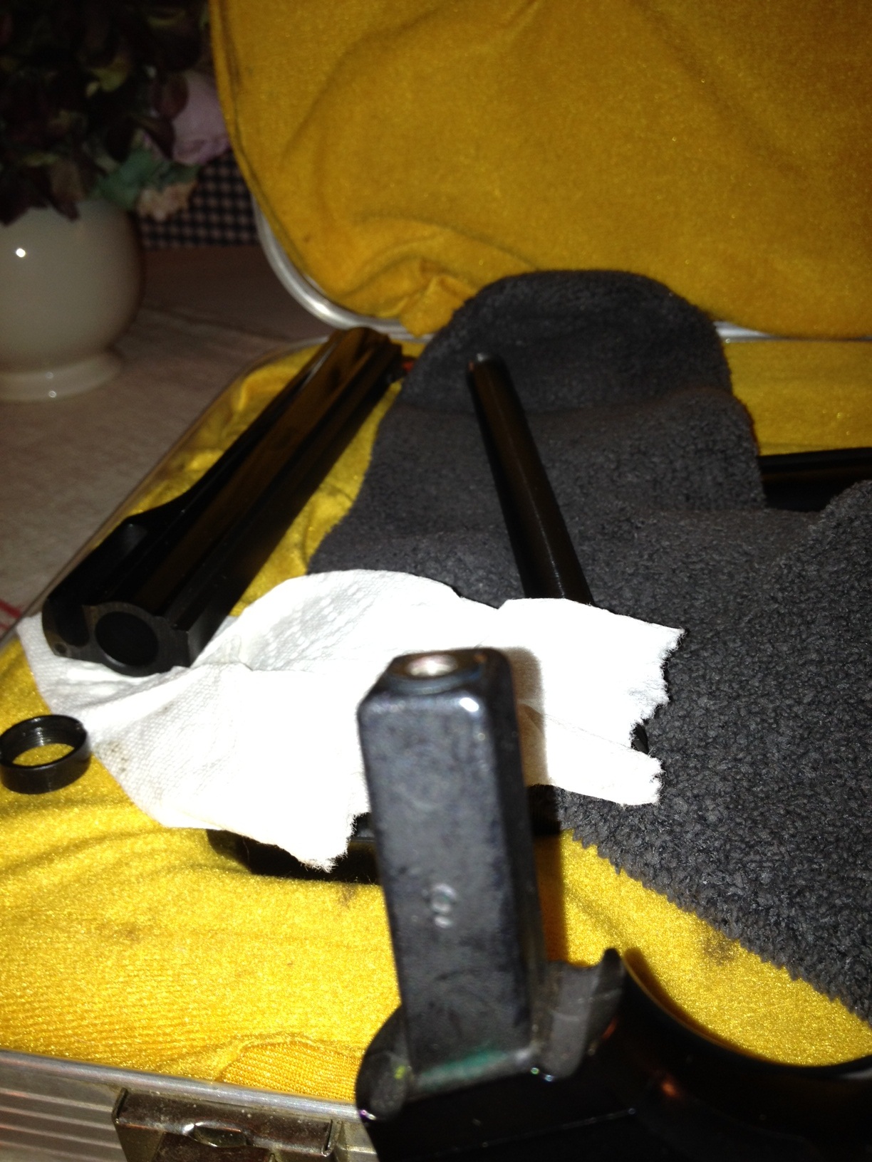

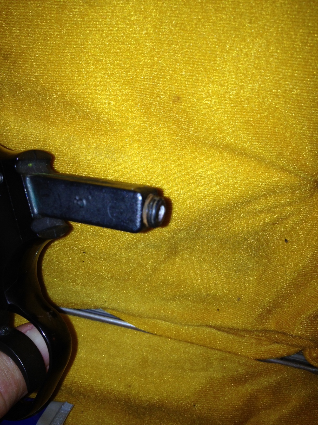

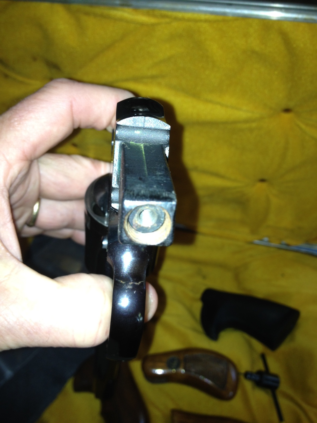

Back in the saddle!  I know you've all been waiting (hah!) but here's the solution to the mainspring seat problem I had, which was preventing my Model 15 from cocking.
I first tried the fingernail polish idea but it didn't set up strongly enough. So, I applied a drop of lock-tite to the grip screw, threaded it into the main spring seat and let it set up for about 1 hr. Then, using the allen wrench tool, I just backed the main spring seat out, no problem. Once I had the seat about 3/8" out of the tang, I grabbed it with a pair of pliers (gently, so as not to damage the threads), and broke the screw loose. I then cleaned everything up, put a drop of lock-tite around the threads of the seat and screwed it into the tang until it sat flush with the tang housing. I used the grip screw with an 8-32 nut threaded abou 1/4" up the shaft of the screw to seat the main spring seat in the tang. I let the lock-tite set up and we're good to go!
Here are before, during and after pictures.
First, a repeat showing the main spring seat recessed into the tang.Image Enlarger
Second, the seat shown with ~3/8" out of tang.Image Enlarger
Third, seat is set flush with tang housing and "lock-tited" in place.Image Enlarger

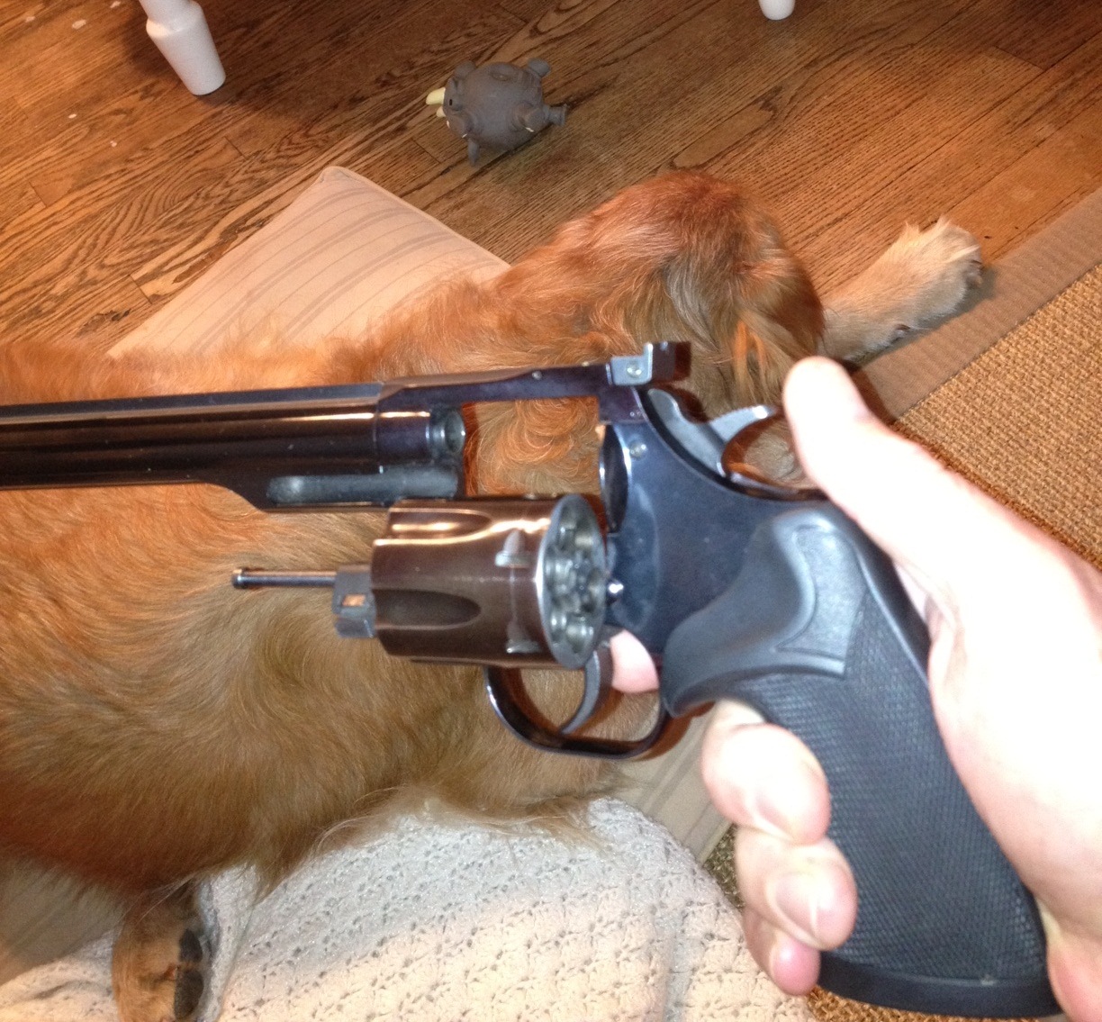

Fourth, gun in working order, and Roscoe, World's Greatest Dog, doesn't care a bit.Image Enlarger

January 26, 2012 - 11:49 am
Great to hear ! Good job occasion  now if that was mine I would take
a chisel and peen on either side but the loctite will probably hold. Which
loctite did you use, blue, red or green ?

January 26, 2012 - 12:26 pm
I used the blue stuff, which I understand can be broken loose without too much trouble, if necessary. Seemed like the best approach, since I don't anticipate any huge torquing forces (e.g., Hulk) to be reefing on my grip screws in the future (LOL).
