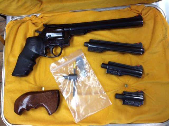

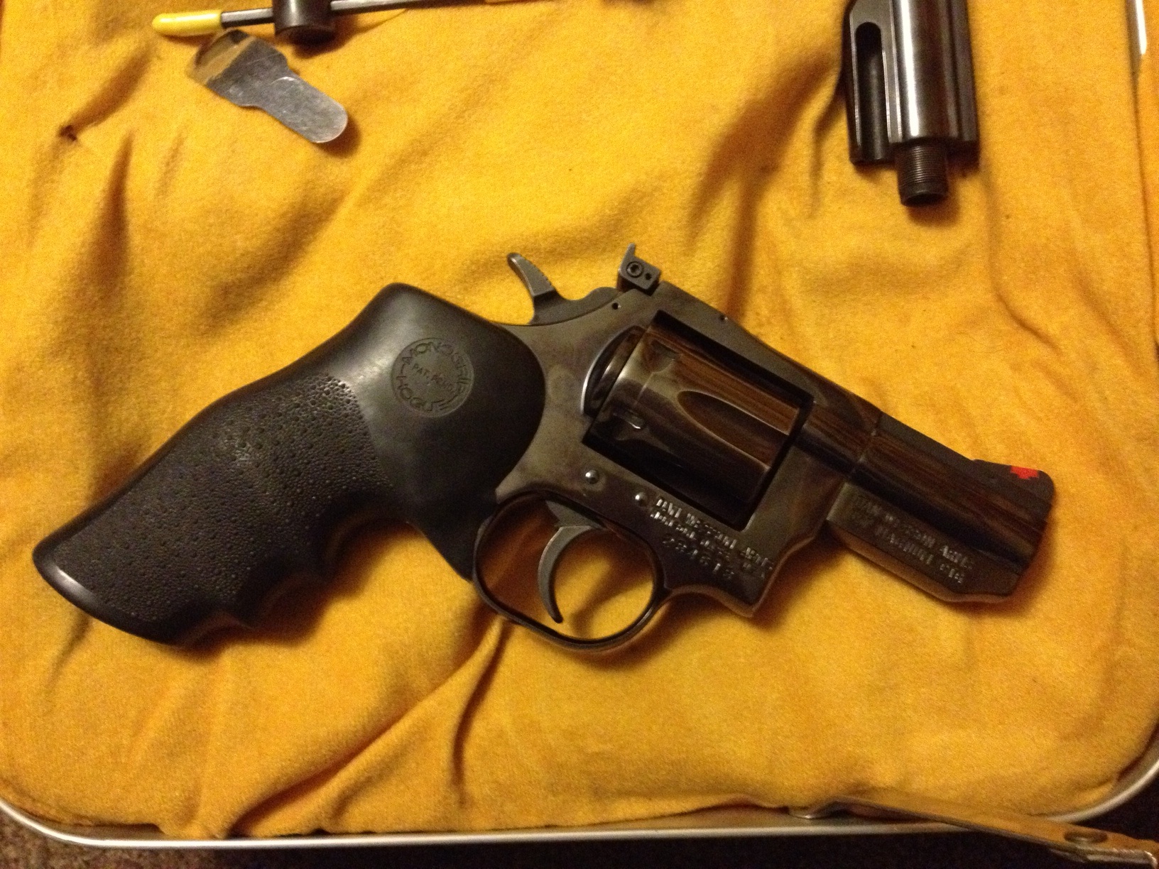

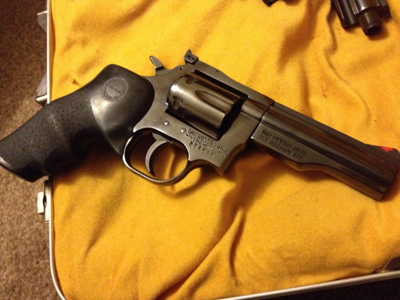

I'll take some pics of what I'm trying to describe at home tonight and post. In the meantime, I've attached a couple of photos of my new piece!
