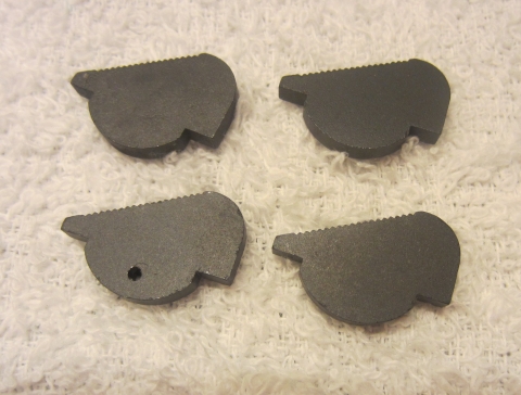

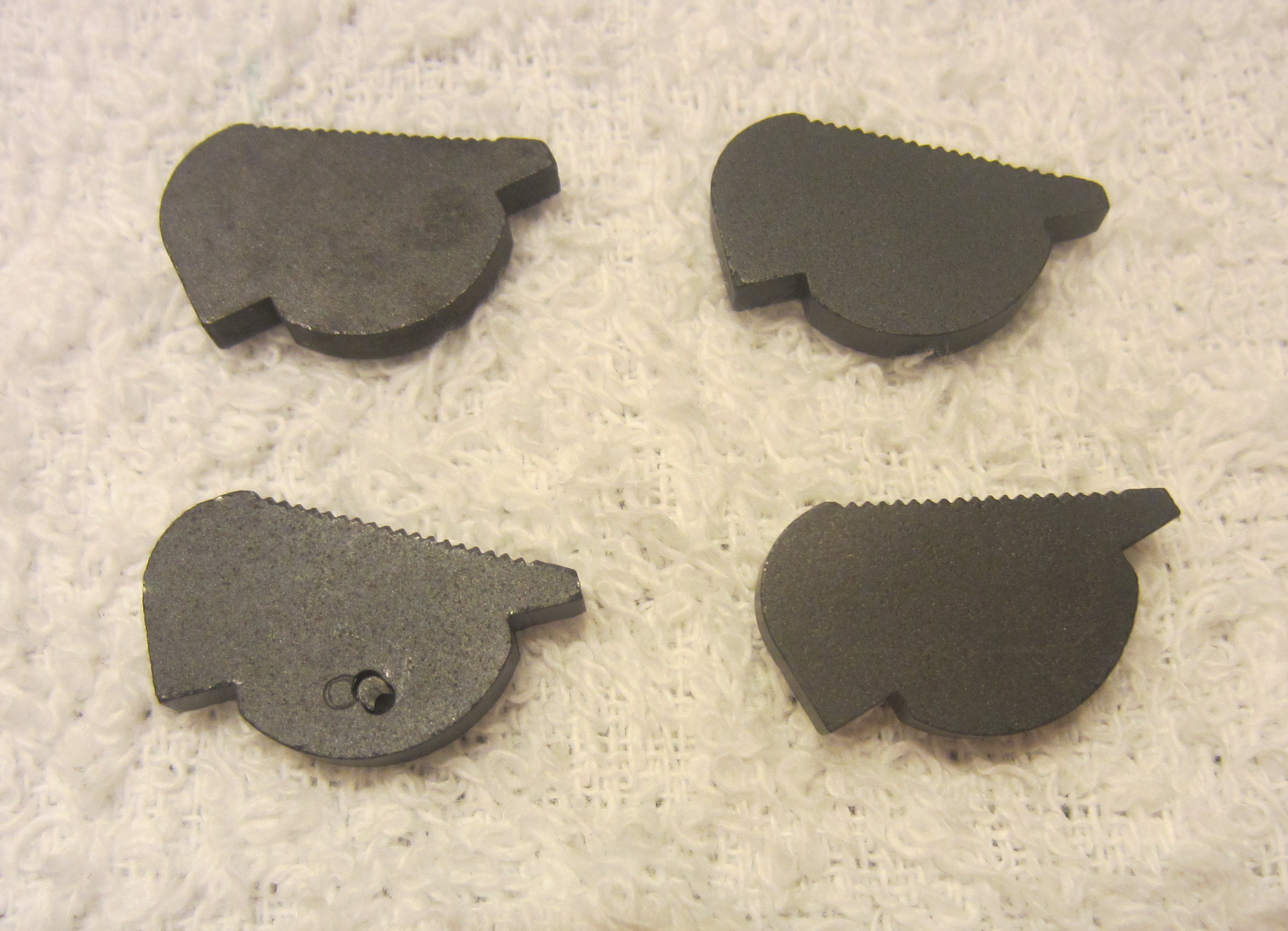

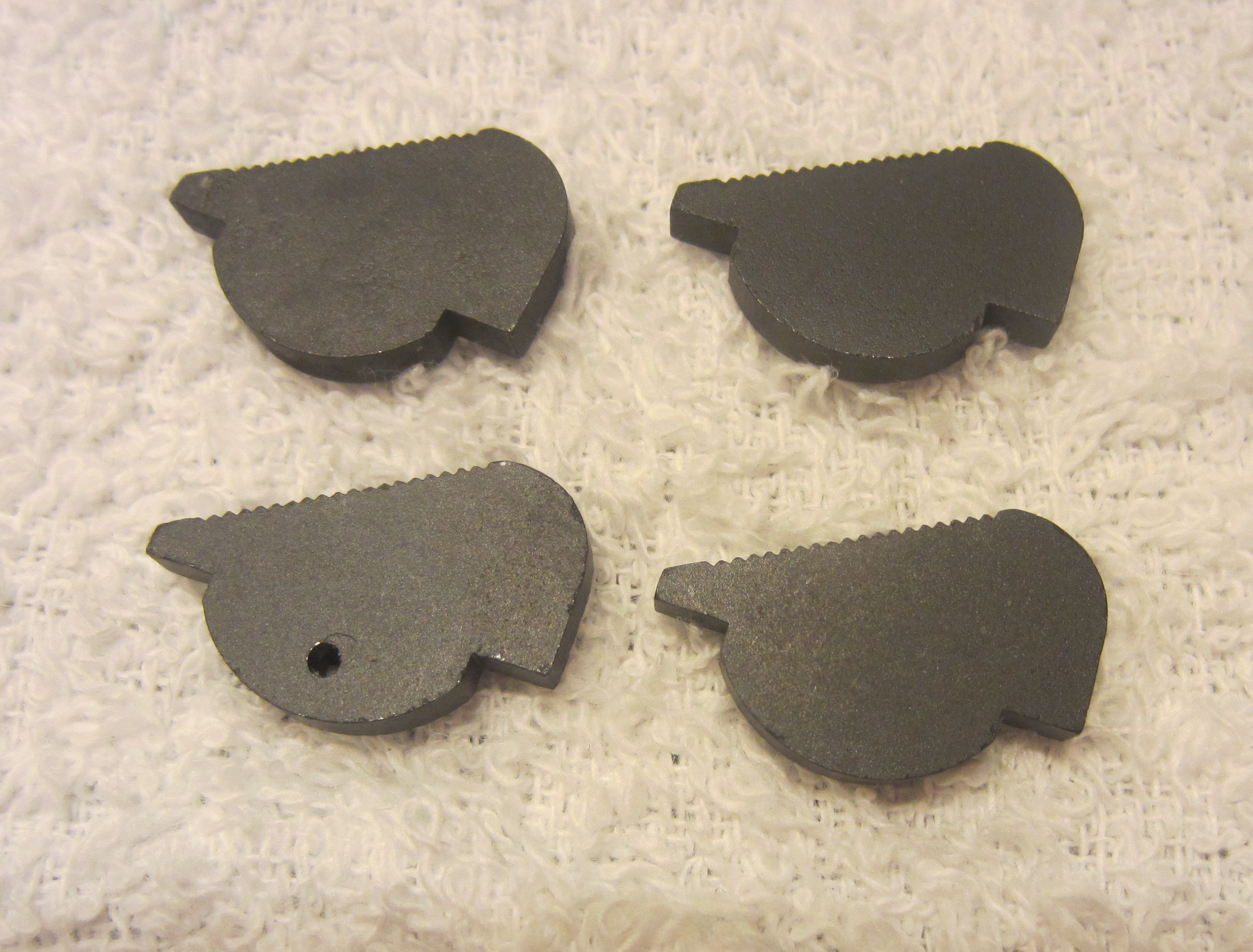

I may have a sight also if you need one. IMG_5228.JPGImage Enlarger
IMG_5227.JPGImage Enlarger

@ Stmstan 445  , Maybe that one sight with hole in it was intended for a 14-2 Shroud?? Maybe. Would you be interested in offing it??

I'm not sure if it will fit but you can PM me with an address and I will send it to you!

Replaced with front sight from @Stmstan 445   the one with the hole in it in above picture..
