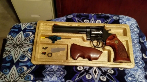

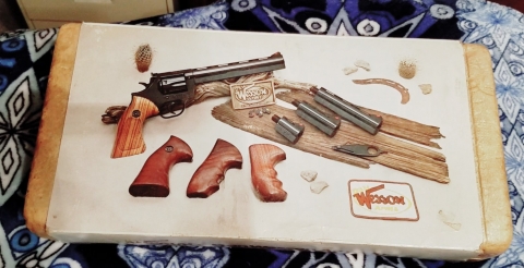

  I bought this revolver as a DW .38 spl. But the frame was a .357. I guess somebody has my .38 frame. Even the numbers match the box.  Always check the cylinder to see if its a .38 spl. I got a good price on it. And I bought it from a Gun store.

Just what I think, the ink marking the model 9 doesn't match the serial number ink.

willy said rnJust what I think, the ink marking the model 9 doesn't match the serial number ink.rn  rn
I hadn't noticed that. I did notice it was a .357 mag. frame later Lol!  It came with the original box and toys too. Everything but the frame, well the serial no. are the same. At least I got a .38 shroud with a new barrel on it at a good price
