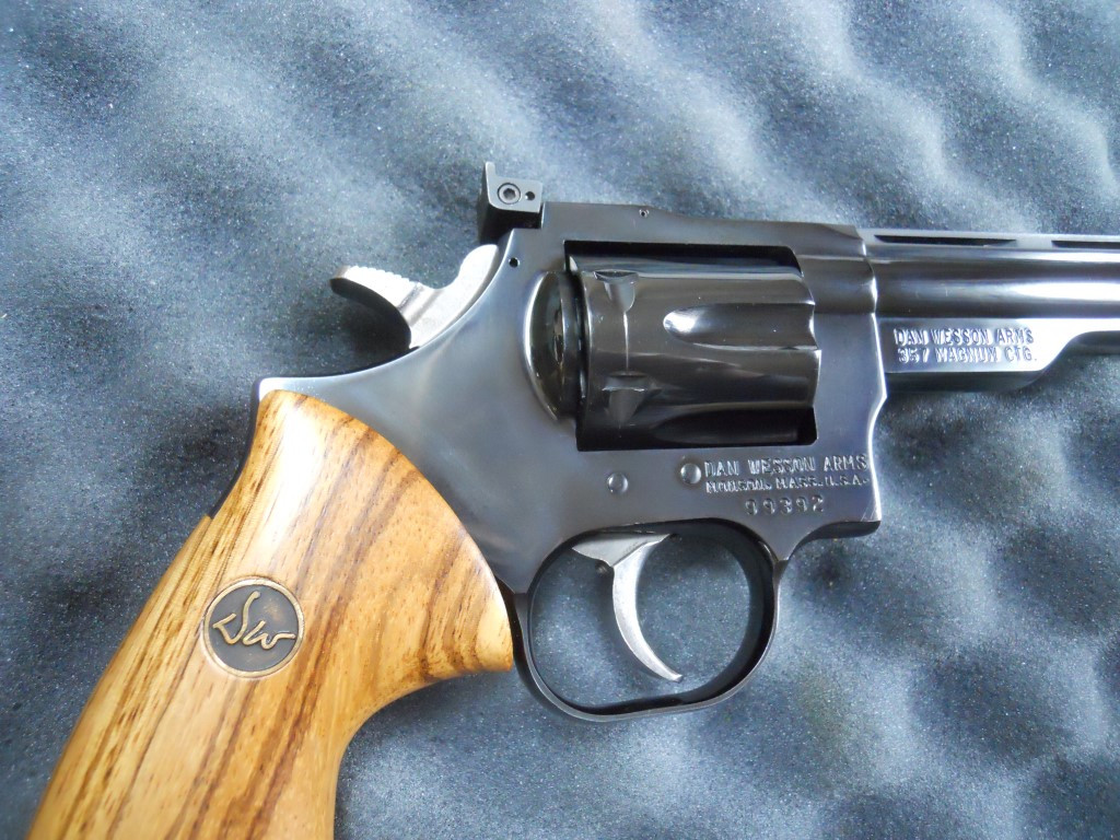

Here's a rare part. It's a small frame stainless trigger with the stop-screw in the trigger itself. I've never seen one like this in a stainless or blue gun from the factory. Have You?

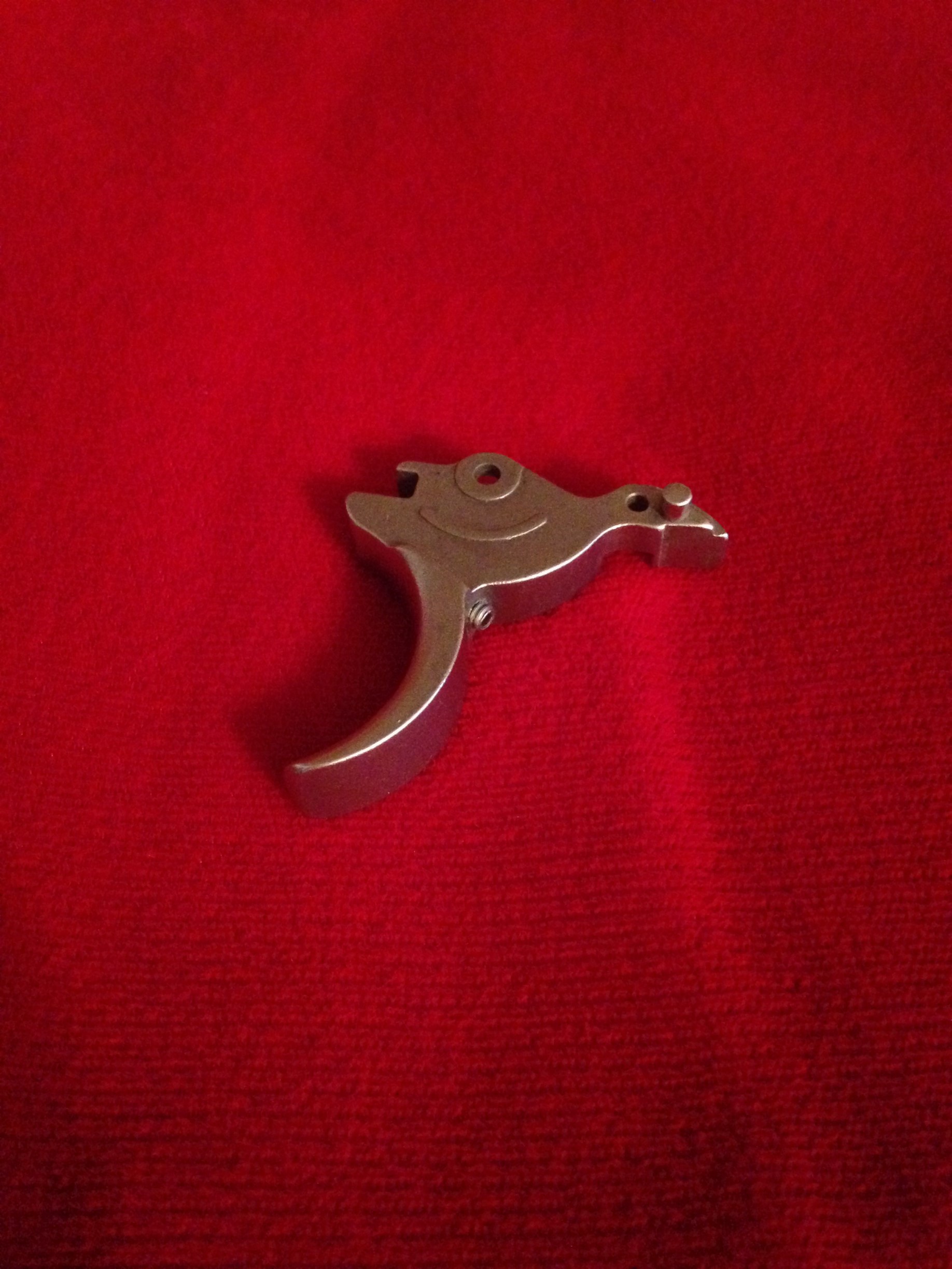

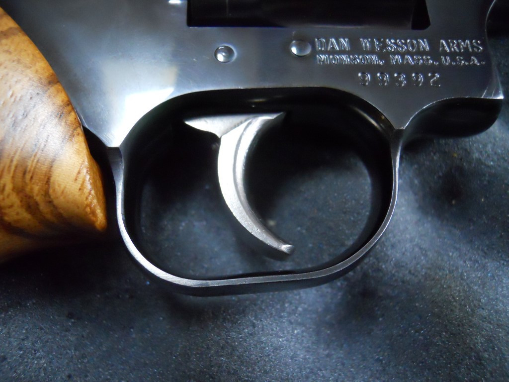

Could it be like the one on my 15-2? I posted pics of this one a few years ago, and the smart guys on here figured it was not stainless, but it is sintered metal. It is a fairly early 15-2. PP5-Medium.JPGImage Enlarger
PP6-Medium.JPGImage Enlarger
July 29, 2017 - 5:08 pm
This appears to be from an earlier production 15-2 that had the overtravel adjustment built into the trigger. Later versions of the 15-2 had the overtravel adjustment as part of the frame.
Very unlikely that this is a stainless component
July 29, 2017 - 5:33 pm
lonwolf, It sure looks like yours. Yours is the first one I have seen on a frame. The one I have was acquired with a number of other stainless parts, notably including some engraved cylinders and shrouds. I did sell a couple of the triggers to members of the forum (before I realized they were somewhat unique). All of the parts were new and never had been installed on a frame. The triggers and hammers are exactly the same (except for the overtravel screw) as the stainless parts on my other 715s. I am guessing that all of the stainless triggers and hammers on 715s were sintered parts, but they are definitely stainless as opposed to steel in the white. I am not an expert, so it may be incorrect or inexact to call sintered parts stainless, but it does seem logical to do so. They certainly have the usual properties of stainless just as other 715 parts do. They do polish quite nicely if you are willing to put in the effort.

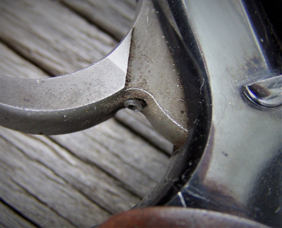

I know it is an old thread but,,,,,,,, my M12 pork chop has one.

my somewhat new to me high standard porkchop has the screw in the trigger also!
