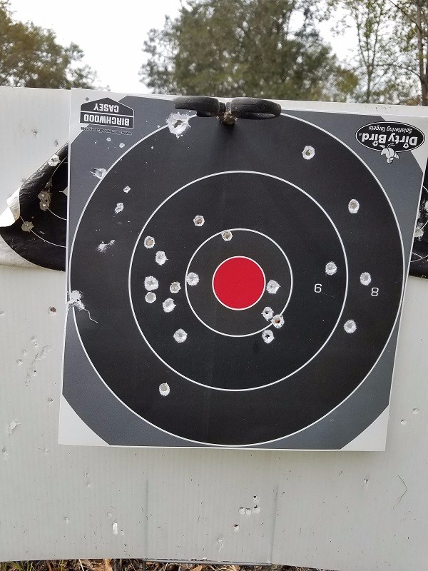

We set up a target at 15-yards and took turns firing three rounds of each cartridge. The

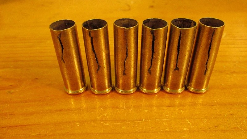

The light 85-gr. bullets in the .32 H&R Mag scooted along at a supersonic 1,263 ft/s, but still only manages 301 ft-lb. All six of these cases had to be forcibly removed and were all split. Interestingly, when we previously fired this same Federal brand ammunition in his Taurus revolver, all the cases split also. We even tried some out of another box from a different lot number, with the same result. The rounds did not feel over-pressured, so we surmise that the problem must be something with the case design, metallurgical alloy or wall thickness.

Here is a close-up pic of the FC head-stamp .32 H&R Mag cases.

Our mediocre target with 24 rounds expended at 15-yards, shows that we were having too much fun !

Glad you had fun!  The cases remind me of when I didn't anneal some work hardened cases properly.  No overpressure signs, they just cracked.  Maybe there's a problem you should let them know about.  Who knows, they may give you a fresh box?
