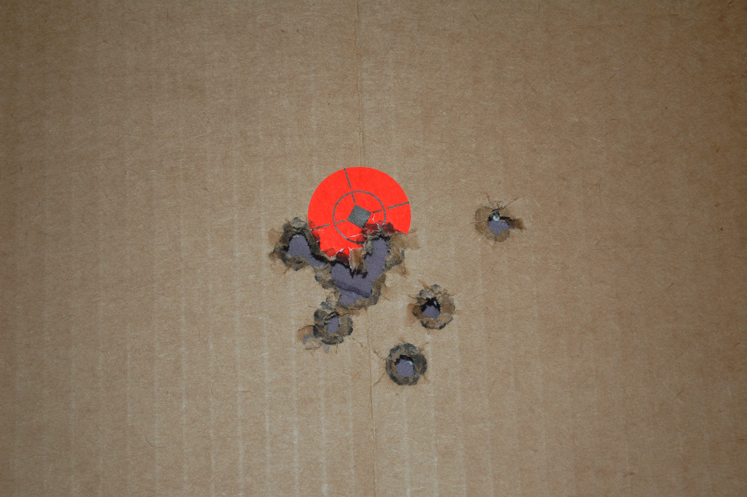

Greetings!  As a new DWA 715 owner, I wanted to wait until I received the tools and gauge before lighting off a hand-canon.  The stuff arrived yesterday and since I had range duty at my local club... it was time!  I checked the barrel clearance, it was good.  I decided to check the sight alignment at 21 feet (one of our combat marked distances).  Shots were grouping about 3 inches high and 2 to the right (supported on a static bag).  When I tried to adjust the elevation, I found a small piece of wood wedged under the sight frame.  That came out and I was able to drop the groups so the POI was = to POA.  I wasn't able to adjust the windage any, as the adjustment for that would not budge with light pressure.  Below is a snap of my unsupported 21ft group with various amounts of "Kentucky Windage" to offset the non-movable horizontal alignment.
For clarification, the Horizontal adjustment has a hex right side (that didn't move) and a flat blade slot on the left.  Before I pull the rear sight off and soak it in WD40 over night, can someone tell me if this adjustment locks?  I'd hate to break something while trying to fix it (DOH!).
 715-after-some-sight-tweeking.JPGImage Enlarger

Good shootin. My sight has an allen on rt. side and has detents/notches, while turning you can feel it.
But no lock that I know of.

Taking a rear sight apart is the first step to buying a new one. Will it turn the other way? Is it on straight. You may be able to shim it right a smidgen. Don't mess with the left side slotted screw.

My biggest fear on sights is the application of too much force.  My kids make fun of the fact that I have wrenches in the tool box "...you tighten stuff too tight with your hands, dad..."  I didn't apply too much force on the L/R adjustment... it wouldn't move CW or CCW.  I was thinking that I would remove the sight and let it soak in some WD40 or liquid wrench before I venture too far with it.  In the event that I use a lil'too much force... are replacement sights readily available?

Soak it in Kroil to loosen rust or crud buildup. The wooden spacer under the sight leads me to think one or more of the elevation springs may be missing or worn out. You will find this out when you remove to soak. There are replacements or substitute sights available. I would bet that the sight on the new 715 would fit and if so then it should be available from the factory. Fiber optic rear sights are also available.
Disassembly of the original sight is a tedious and not likely rewarding process. There is a secret to reassembling that I don't knowcryBeen There!
If you do go that route, I have replacements for the internal parts in case you lose one or they are too far gone to re-use.
